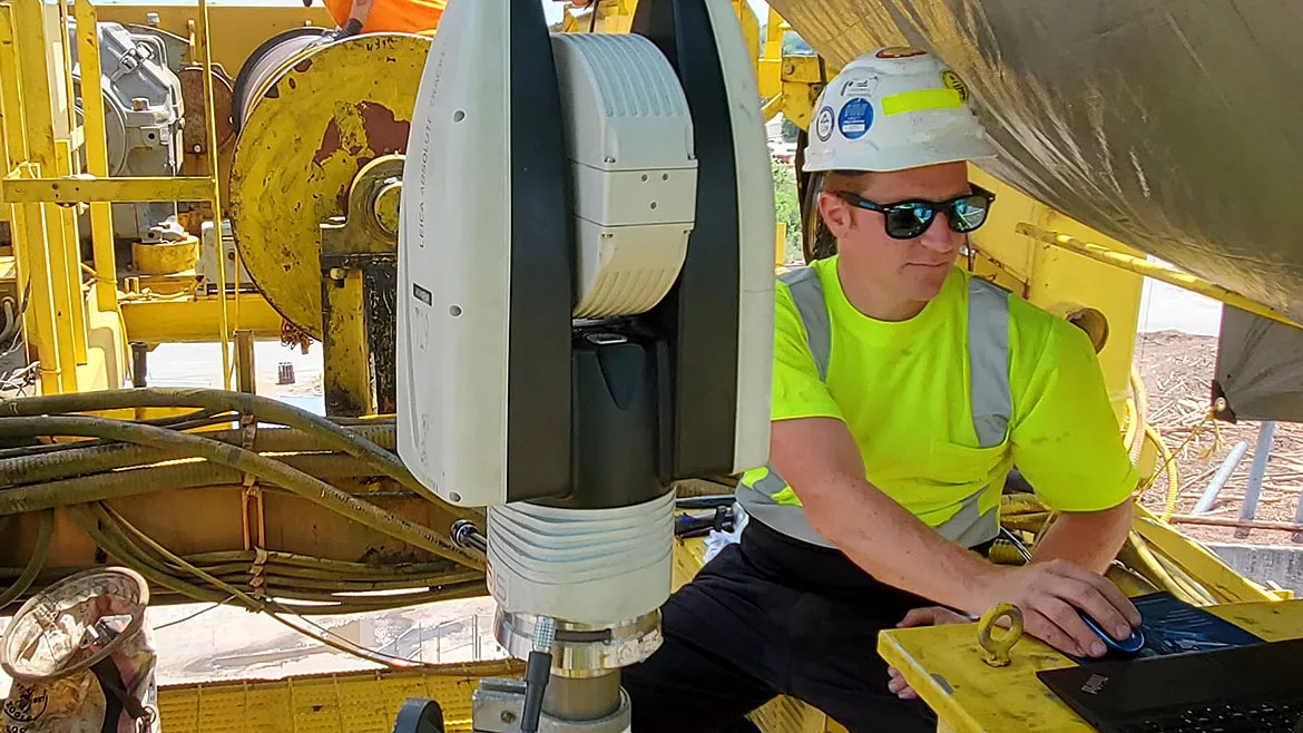

Laser Tracker for Crane Inspection
Image Source: In-Place Machining Company

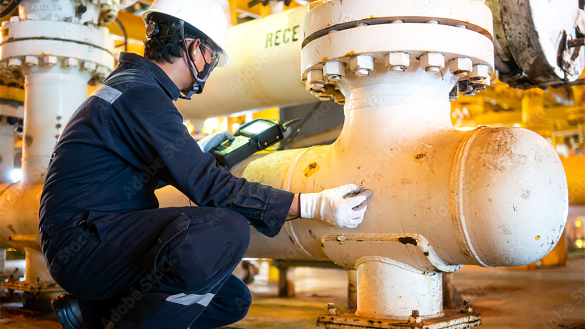

Inspecting pipes using ultrasonic NDT instruments at petrochemical facility.

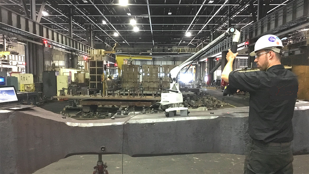

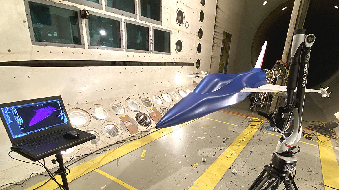

Aero-with-Arm

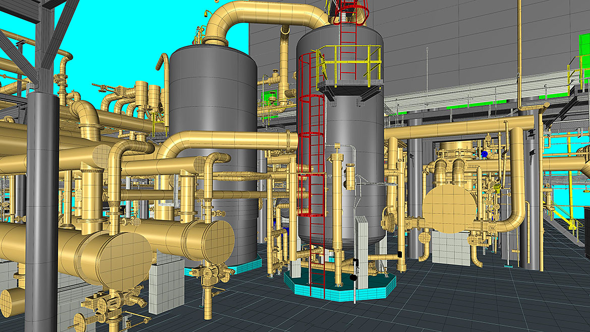

Model of refinery piping long-range scanner and modeling software.

Capturing accurate geometry is only the first step; the value lies in how quickly teams can convert scan data into actionable insights. Modern processing platforms now allow for point cloud conversion, CAD-based comparisons, inspection reporting, and reverse engineering directly at the point of service.
In industries such as aerospace, technicians can rapidly verify assemblies or model aging components. In refining or chemical processing environments, 3D scan data supports validation of installed piping and structural integrity—minimizing rework and reducing the length of scheduled shutdowns.

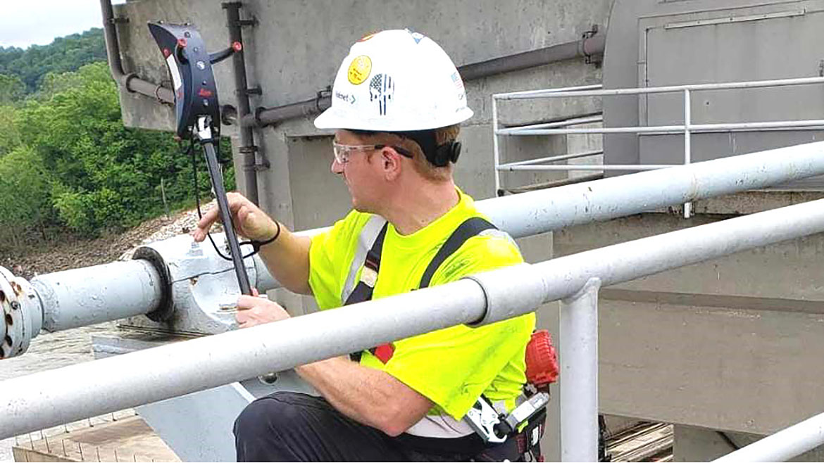

T-Probe

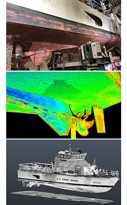

Using long range scanners on Coast Guard Cutter.
