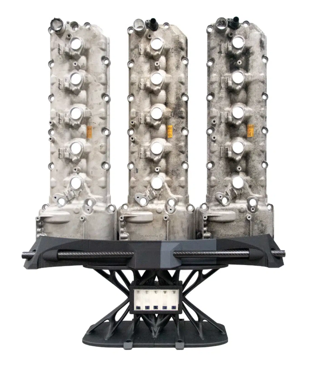

Samples

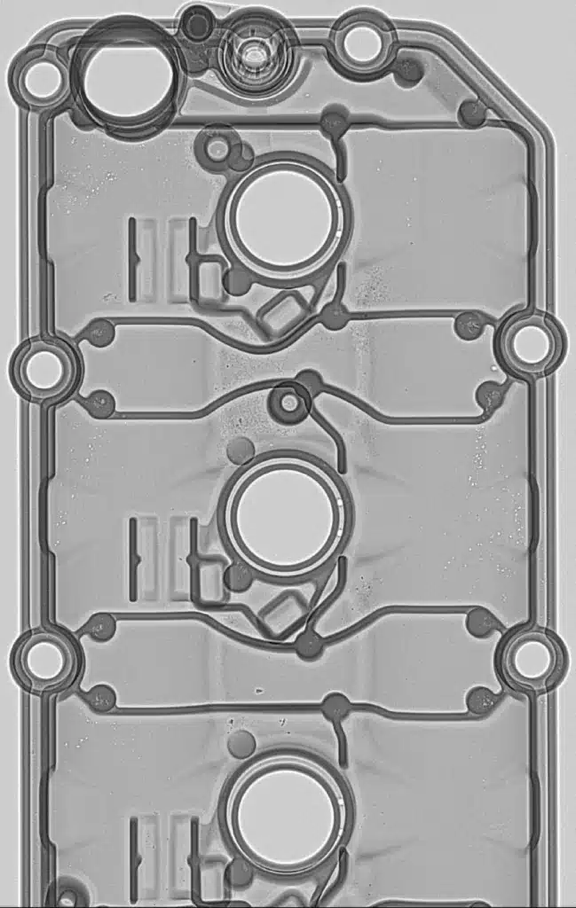

The study utilized three aluminum cast valve covers from a V10 engine [Fig. 1], selected for their relevance to casting industry challenges in both aerospace and automotive. These parts exhibited natural defects such as gas porosity, shrinkage, inclusions, and dross, while simulated cracks were introduced across varying wall thicknesses—from thin to thick zones—to test detection limits. This diversity ensured a robust evaluation of the system’s capabilities.
Fig. 1: Aluminum cast valve covers from a V10 engine with a specially designed fixture. Source: North Star Imaging

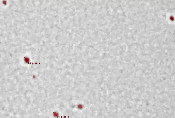

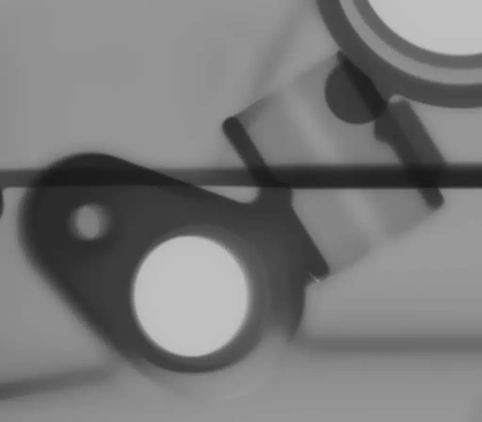

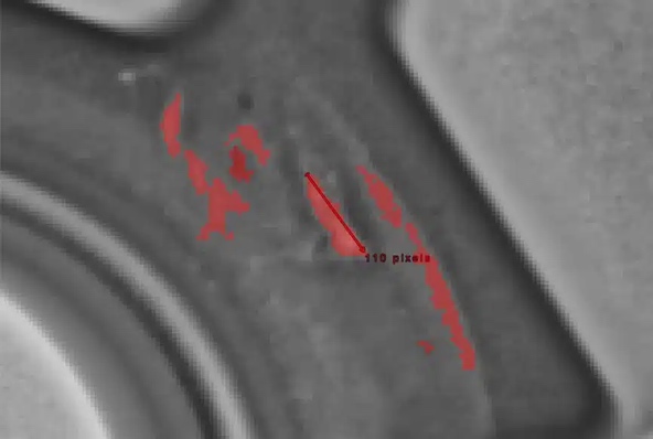

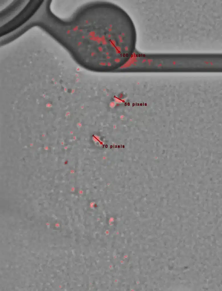

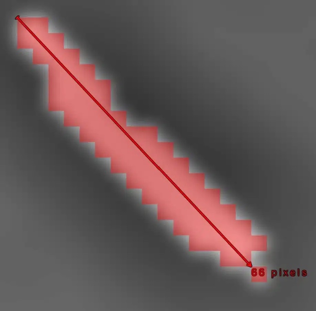

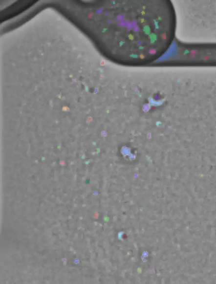

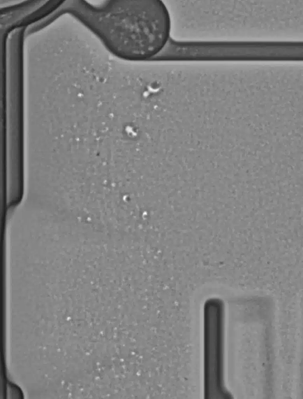

In a small case study, we evaluated the repeatability and reproducibility of detecting specific indications in castings using a 60-second motion program, conducted over three days. Parts were unloaded and reloaded between each run to test reproducibility. The study focused on detecting four indication types as shown in Figure 2:
  • Foreign material (inclusions)
  • Shrinkage
  • Gas porosity
  • Simulated cracks
Detection of inclusions, shrinkage, and gas porosity achieved repeatability and reproducibility of 99% or higher. Simulated cracks were more challenging, particularly in material thickness transition zones. A rule-based image processing chain was configured to identify all four indication types.
Inclusions (Size filter: min 20 pixels)       Shrinkage (Size filter: min 100, max 120 pixels)
Gas Porosity                                       ADR threshold                       ADR annotation
 (Size filter: min 50 pixels)
 Original Image
Simulated Cracks (Size filter: min 50 pixels)
Fig. 2: Indications which were part of the ADR study. Source: North Star Imaging
Summary of Study

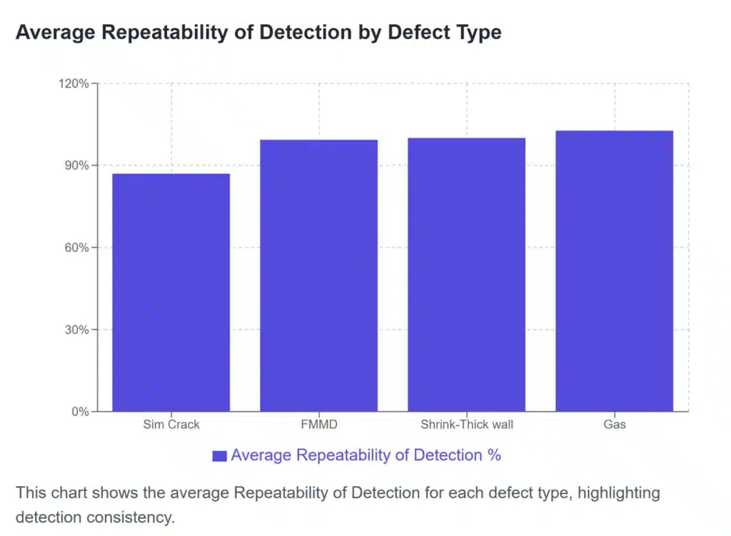

This study analyzed the performance of an Assisted Defect Recognition (ADR) using an automated processing system across 360 trials, focusing on repeatability of detection in radiographic testing. Key metrics include Repeatability of Detection and Pixel Coverage. The ADR processing time is consistently 1.5 seconds per image.
  • Overall Average Repeatability of Detection: 97.25%
  • Defect Types Analyzed: 4
  • The defect type “Simulated Crack” has the lowest average Repeatability of Detection at 86.97%, indicating potential challenges in detection.
Fig. 3: Chart showing average repeatability of detection by defect type for the ADR used in the study. Source: North Star Imaging

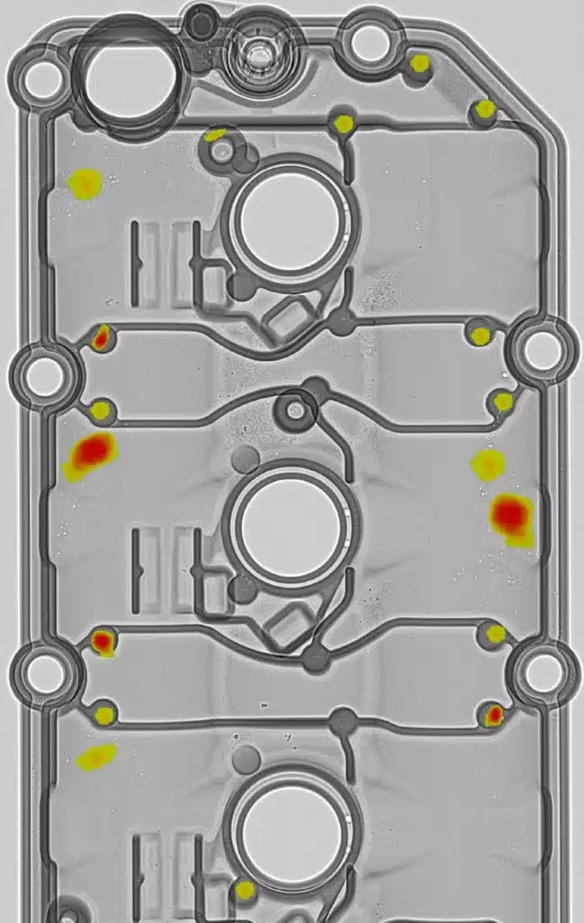

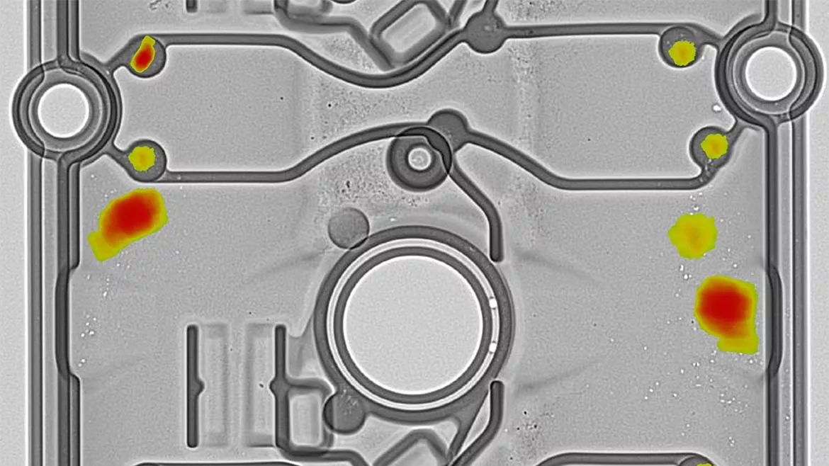

Heat Map in ADR
In engineering, comparing actual product output to designed input is crucial. The ADR system used provided a valuable feature that helped pinpoint problem areas in parts. It analyzed a large set of ADR images, identified indication locations and displayed them as shaded, color-coded spatial mappings based on severity.
Fig.4: Heat map showing technician areas of interest for further interpretation. Source: North Star Imaging
