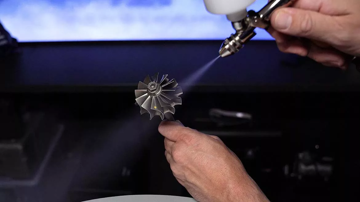

Airbrush for challenging scanning work.
Image Source: AESUB
Airbrush for challenging scanning work. The airbrush and scanning spray are particularly suitable for situations in which fine details need to be captured.

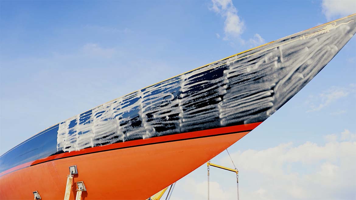

Upward view of the hull of the boat with a cloudy blue sky in the background. The hull is matted and ready for scanning.
The entire hull of the boat is matted. The scanning process can begin. Image Source: AESUB

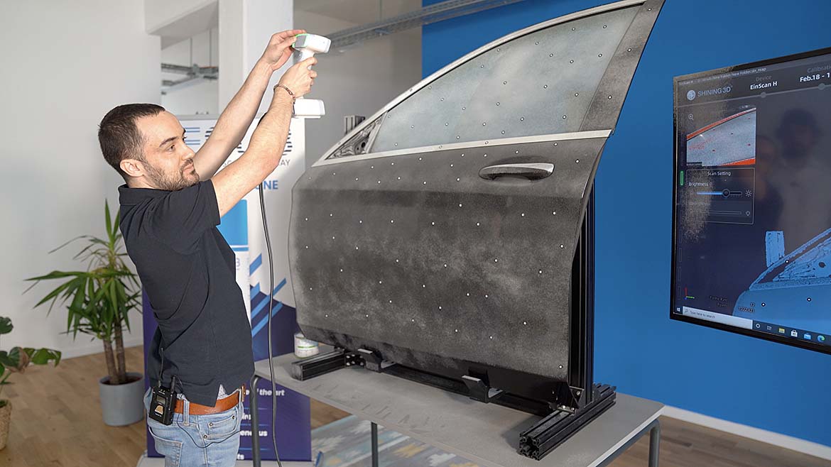

Worker prepares a car door for scanning process.
Car door prepared for the scanning process: Matted with scanning spray and retro-reflective reference dots. Image Source: AESUB

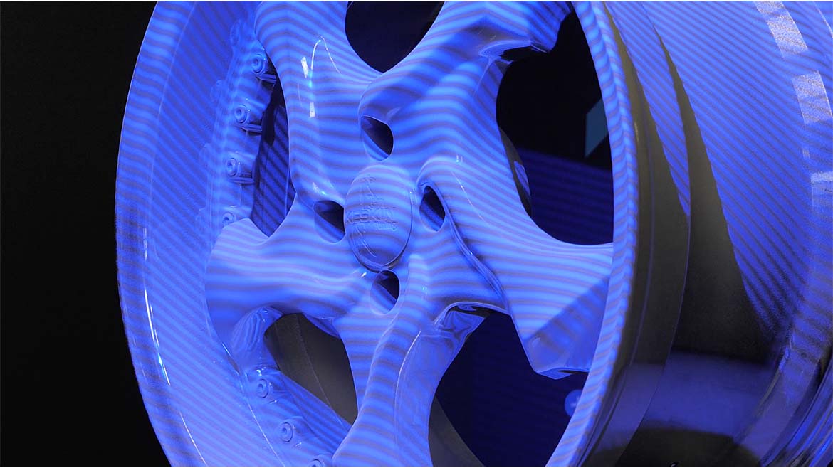

Highly polished car wheel rim matted with scanning spray, dimly lit with a purplish glow.
The highly polished car wheel rim was matted by using a scanning spray. Even cavities can be detected by the scanner. Image Source: AESUB

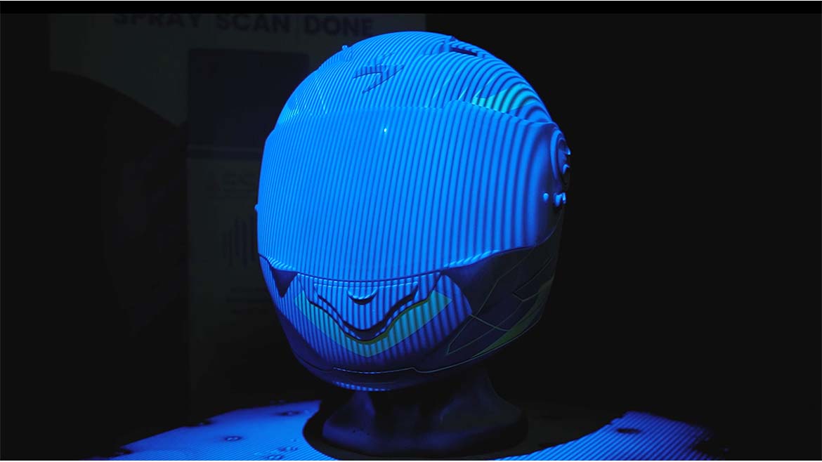

Matted helmet during the scanning process, dimly lit with a black background.
Matted helmet during scannings process. Image Source: AESUB

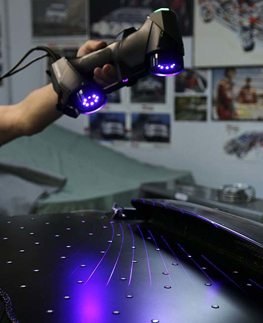

Scanning process using retro-reflective targets.
Image Source: AESUB

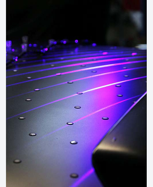

Close-up of object being scanned using magnetic retro-reflective targets. It's dimly lit with a purple glow and a blurred background.
Image Source: AESUB

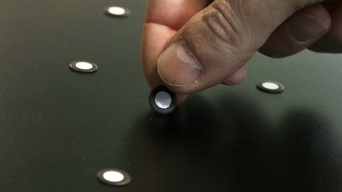

Close-up of a hand placing magnetic retro-reflective targets
Image Source: AESUB
Magnetic retro-reflective targets are used for 3D scanning of metallic components with laser light. These can be quickly and easily placed on the metal surface to be scanned and removed just as quickly after scanning.
Trending: Magnetic retro-reflective reference points
Magnetic retro-reflective targets have become particularly popular for 3D scanning of metallic components with laser light. These can be quickly and easily placed on the metal surface to be scanned and removed just as quickly after scanning – in contrast to adhesive reference points, which are time-consuming and very laborious to remove. Magnetic reference points are reusable indefinitely and, unlike many conventional reference points, leave no adhesive residue on the components.
The retro-reflective surface guarantees high accuracy and stable detection by the scanner, even in difficult lighting conditions and on dark surfaces. The magnetic backing ensures secure placement on any magnetic surface.
The key advantages of the new reference points are their reusability and the resulting long-term cost efficiency. After scanning, the magnetic reference points can be easily removed from the surface and used for other applications – without leaving any residue or causing any damage. This accessory significantly reduce material costs compared to disposable reference points. Magnetic reference points are available with diameters of six and three millimeters.
