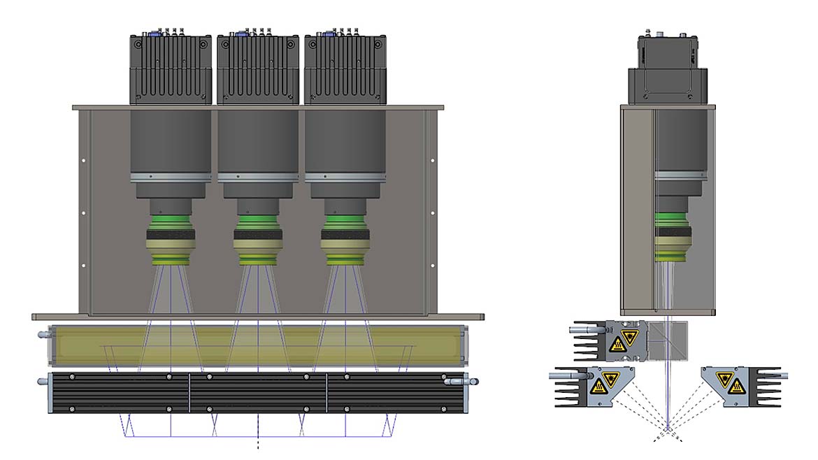

To capture the complete geometry of a 300 mm wafer at high resolution and fully cover a field of view of this size, multiple cameras arranged side by side may be necessary. Modern innovation allows direct synchronization between multiple line-scan cameras, resulting in perfectly aligned composite images from the cameras, simplifying subsequent image processing.
Example setup of two 16k cameras covering 320 mm scan width with a resolution of 10 µm and combined light: dark field and coaxial light
Example setup of two 16k cameras covering 320 mm scan width with a resolution of 10 µm and combined light: dark field and coaxial light. Image Source: Chromasens GmbH
Another unique feature of modern line-scan cameras is their multi-field imaging capability. This technology leverages an integrated multi-channel flash controller to synchronize up to four light sources with the camera’s line trigger in a rapid sequence. Consequently, up to four images are captured in a single pass, each taken under different lighting conditions. This approach reduces the number of cameras installed, simplifying the inspection process, and contributing to the overall optimization of process cost.
