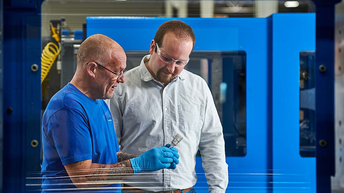

In medical device manufacturing, precision is not optional. Every molded component must meet exacting requirements for safety, reliability, and compliance. It is rarely possible to confirm those requirements through final inspection, as critical characteristics such as bonding strength and cure completeness often cannot be measured after molding. Validation therefore provides evidence that the process itself is capable of consistently producing parts that meet specification.
Medical Beacon
Source: Beacon MedTech Solutions
For medical devices, validation isn’t just good business practice; it is a requirement. As the FDA regulation and ISO 13485:2016 demand that where the results of a process cannot be fully verified by inspection and test, the process MUST be validated with a high degree of assurance.
In regulatory terms, that means quality must be built into the process rather than inspected once parts come off the press. Similar expectations apply to processes such as sterilization, welding and bonding, where hidden defects or shifts in material behavior may not be visible until products are already in use. For manufacturers, this classification reinforces that validation is not only a compliance requirement, but a safeguard for long-term performance and patient safety.

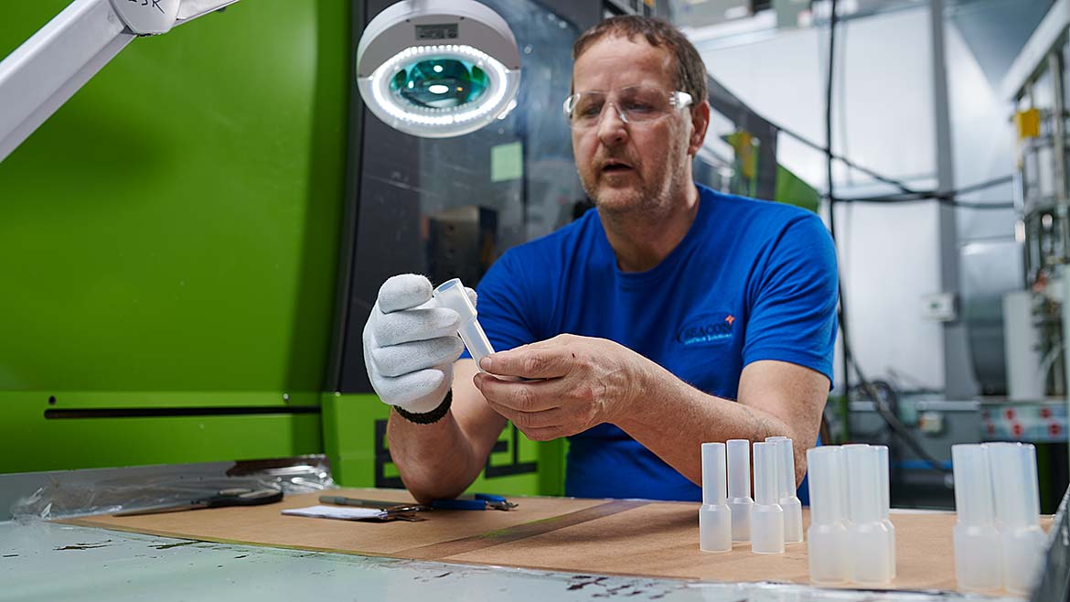

An understanding of how one material behaves often leads to incorrect assumptions when utilizing new materials. Validation for thermoplastics differs significantly from validation for liquid silicone rubber (LSR), for example. Thermoplastic molding focuses on controlling melt temperature, injection speed and cooling rate to prevent warpage, short shots or dimensional drift. Shrinkage must be thoroughly characterized because it influences tolerance stack-up across assemblies.
LSR molding presents its own complexities, involving the chemical process of curing and bonding, rather than thermal process concerns. Parameters such as cure time, material ratio and mold temperature directly affect durometer, bonding strength and dimensional stability. Validation must include detailed verification of these variables, often through thermal mapping and mixing accuracy studies. Ignoring these differences can lead to inconsistent part performance and costly requalification.
It’s also important to understand how materials interact, whether in a process like overmolding or later in assembly. The compatibility of surfaces, adhesives and cure cycles can affect adhesion strength, dimensional stability and long-term performance, all of which must be considered during validation.

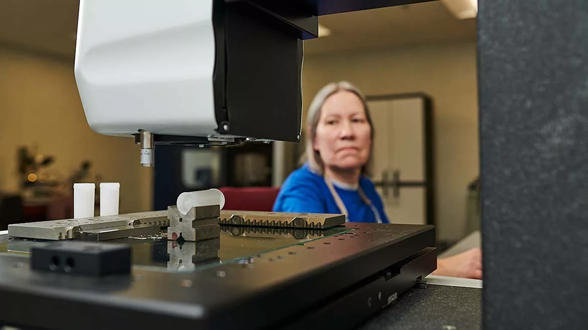

Dimensional Control
Maintaining dimensional control is also part of sustaining any validated process. Measurement systems used in capability analysis must be qualified and repeatable so that data reflects true process variation, not inspection error. Consistent fixturing, calibration and environmental control ensure that validation results remain reliable over time.
Incomplete dimensional definition can also derail validation. For example, one program experienced setbacks due to the misalignment of mating parts after shrinkage distorted four screw hold positions. The drawings lacked defined locations and a clear datum structure, making accurate measurement impossible. Updating the prints with ANSI GD&T true position callouts and creating a focused inspection routine corrected alignment and enabled meaningful capability analysis. The issue showed how unclear dimensional data can compromise validation before production starts.
