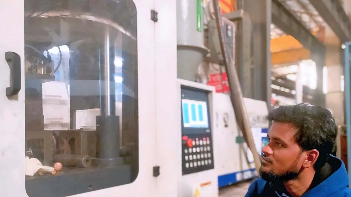

This image shows an industrial worker monitoring a plastic injection molding machine.
Image Credit: Mohammad Safar Ali
