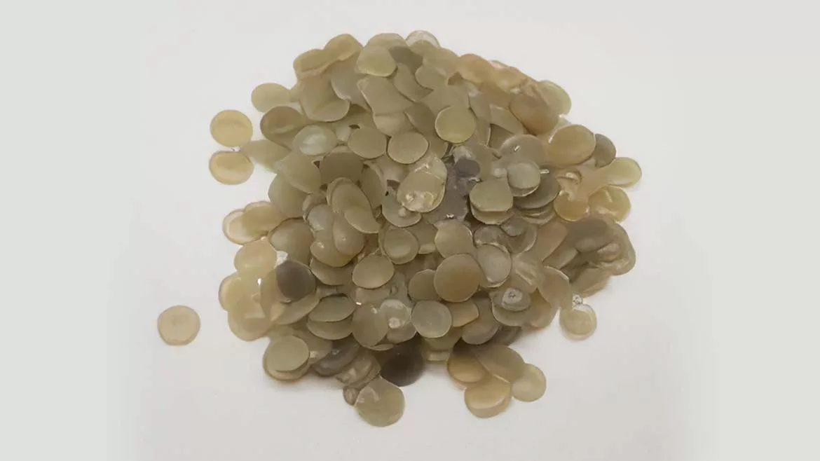

Additional processing steps can “age” recycled plastic, causing it to yellow.
Source: Datacolor
Figure 1: Additional processing steps can “age” recycled plastic, causing it to yellow.

Post-consumer recycled materials (PCRs) are frequently mixed when melted down. The resulting polymer is often some shade of gray, which can vary considerably between batches. This makes it difficult to create brilliant colors such as bright blues or reds, and it’s challenging to reproduce most colors consistently.
“Plastic waste from your household comes in almost every color you can imagine, including fluorescent and sparkling. Every sorting step is a matter of time and money, so the material isn’t usually sorted by color,” Mittelberg explained.
As a result, time and effort are typically taken only to separate white, transparent and natural materials, which are in greater demand for reuse. The grayish mix that results from the remaining unsorted items is usually only suitable for matching darker colors.
“Even if you have color-sorted feedstock, every additional processing step ages recycled plastic and can change its color. For example, white and transparent material can take on a yellowy appearance,” Mittelberg said.
