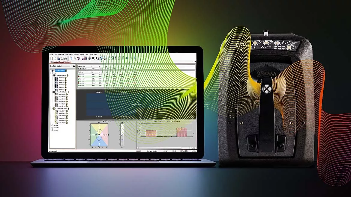

Laptop with color analysis data next to X-Rite benchtop spectrophotometer with virtual green and yellow soundwaves and a colorful gradient background.
Image Source: X-Rite

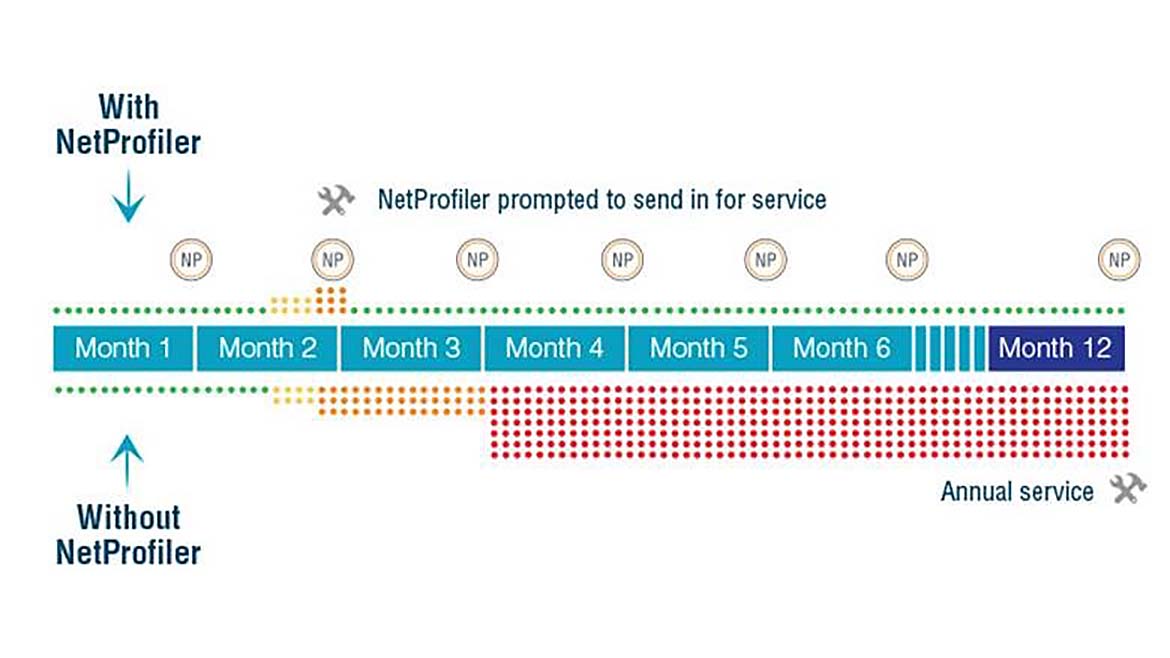

For broader, long-term optimization, cloud-based tools help ensure measurement consistency across devices and locations. These tools go beyond daily calibration by detecting wavelength shifts, correcting for environmental drift, and generating device-specific correction profiles based on comparisons to traceable reference values. Recognized as an ISO 9001-compliant calibration quality process, it helps align one instrument or a fleet of devices to a common standard - so a color measurement taken in Detroit matches one taken in Germany.
Used monthly, calibration and profiling software act as preventive maintenance for your color measurement devices, reducing the risk of costly color mismatches, ruling in or out instrument-related issues, and ensuring accurate, reliable color data across your operation.
X-Rite NetProfiler and benchtop spectrophotometer. X-Rite NetProfiler and benchtop spectrophotometer. Image Source: X-Rite
Monthly device calibration using NetProfiler helps maintain accuracy and detect issues early between annual services. Monthly device calibration using NetProfiler helps maintain accuracy and detect issues early between annual services. Image Source: X-Rite

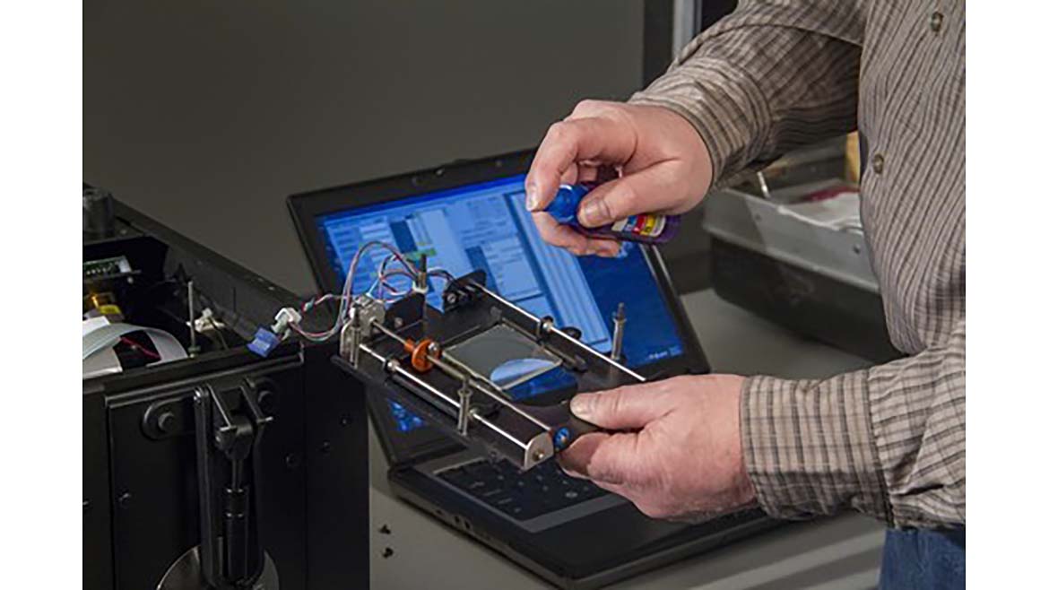

Even with a regular calibration routine, instruments will eventually require servicing. Warning signs such as prolonged calibration times, inconsistent readings, or physical damage are often indicators that an instrument is no longer functioning at peak performance. An annual factory certification, where devices are cleaned, tested, and aligned to national standards such as NIST and ISO, is essential to maintaining color consistency.
Ignoring these signs can compromise the reliability of an entire color workflow. A single misaligned or dirty spectrophotometer in a production network can introduce variability that ripples across hundreds of products, costing valuable time and material. Regular servicing ensures devices remain accurate, in good working order, and aligned with global standards.
A technician performs annual servicing and certification on a spectrophotometer. A technician performs annual servicing and certification on a spectrophotometer. Image Source: X-Rite
