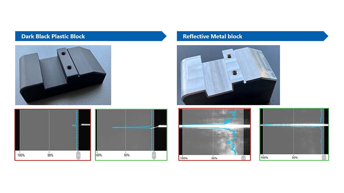

This image demonstrates the performance of an industrial sensor
Source: Baumer
Different surfaces present specific challenges that require tailored approaches. Polished metals, for example, can produce specular reflections or signal saturation. These challenges can often be mitigated by adjusting the triangulation angle, using optical filters, or selecting shorter wavelengths. Mounting stability is also critical; vibrations or misalignment can translate directly into measurement noise. Black rubber and dark plastics, which absorb more light, benefit from sensors with high dynamic range and careful selection of standoff distance, along with wavelength optimization to ensure sufficient signal return. Transparent or translucent materials require attention to penetration depth and reflection from subsurface layers. Shorter wavelengths can improve surface measurement accuracy, and optical filtering or angle adjustments can further reduce unwanted reflections. Hot materials, such as steel in processing lines, add another layer of complexity, as thermal radiation can interfere with optical measurements. Narrow-band optical filters and careful sensor placement can help minimize these effects.

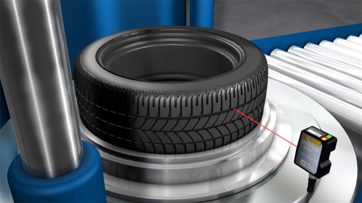

The image displays a tire inspection system used in automotive manufacturing to ensure quality and safety.

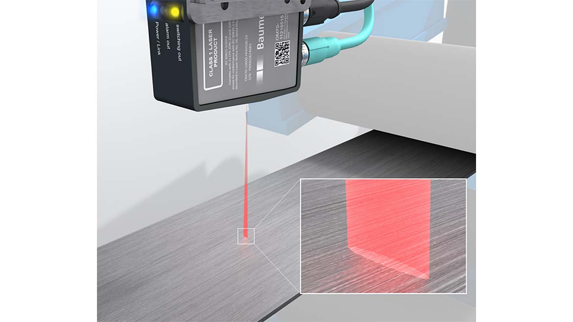

The item shown is a Baumer OM70 series laser distance sensor
Source: Baumer
The choice of measurement principle also interacts with surface challenges. Laser triangulation sensors generally offer higher precision at short to medium distances but are more sensitive to surface properties. Time-of-flight sensors, on the other hand, are better suited for longer distances and are less affected by surface microstructure, although they typically provide lower precision. When micron-level accuracy is required on difficult surfaces, triangulation sensors with optimized wavelength selection often provide the most reliable results.
