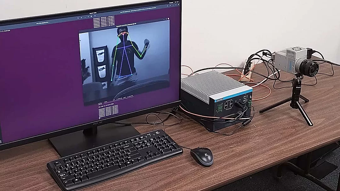

This image displays a high-speed machine vision system used for real-time human pose estimation.
Image Credit: BitFlow
Real-time human pose system incorporating BitFlow CoF frame grabber, Advantech AI edge computer, and Optronis fiber camera, accelerated by NVIDIA TensorRT deep learning.

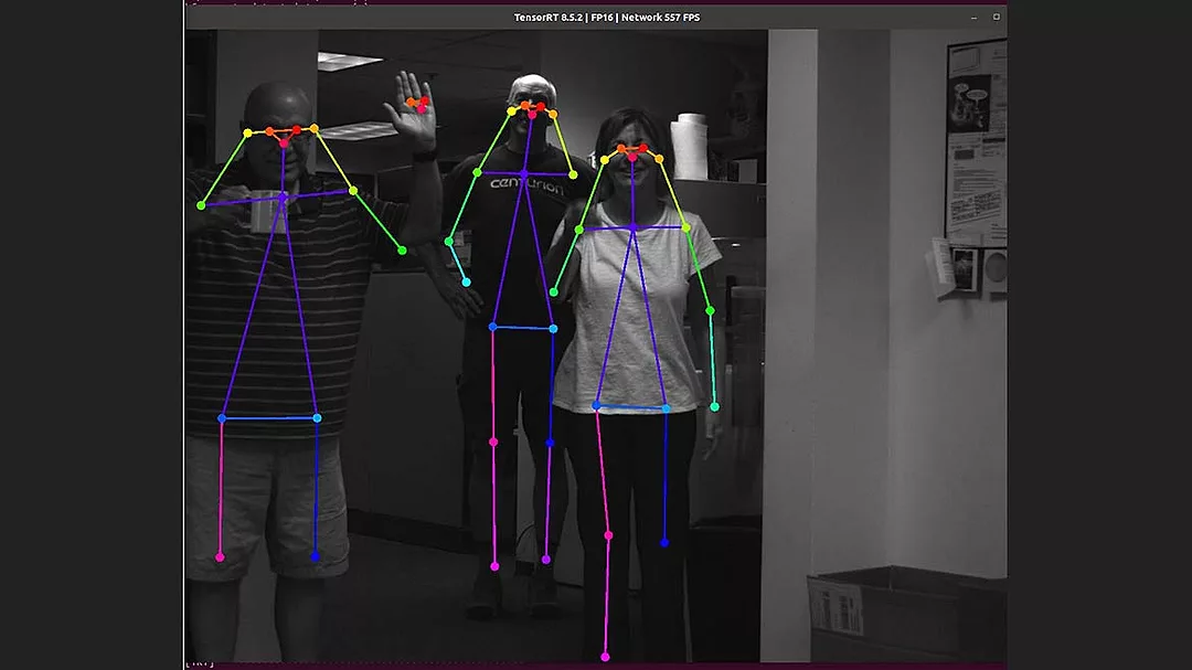

This image displays a real-time human pose estimation system in action.
