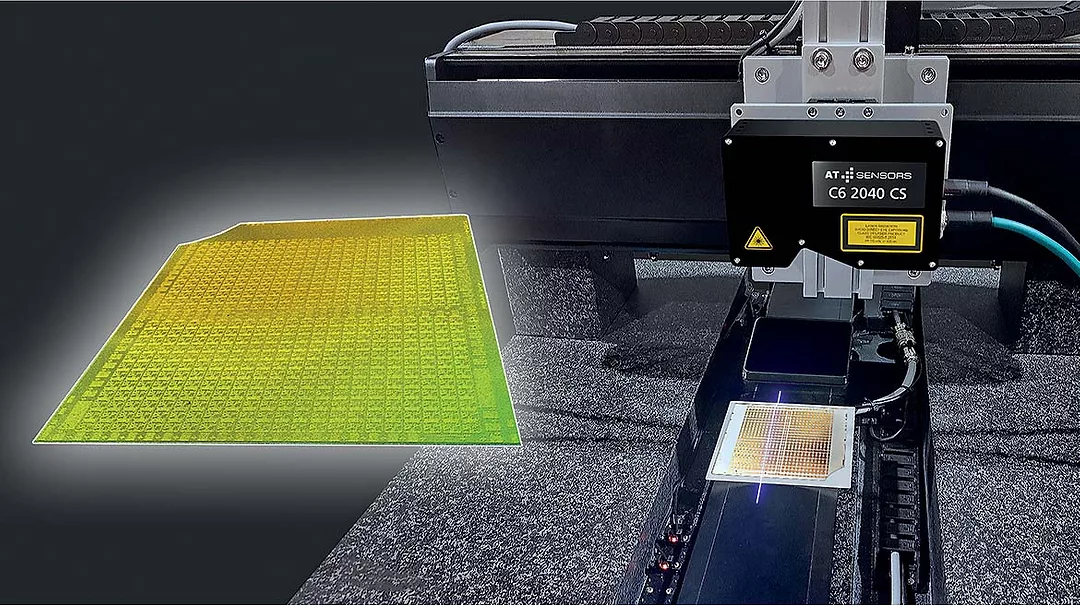

Semiconductor device inline planarity check with AT-Sensors 3D laser profilers.

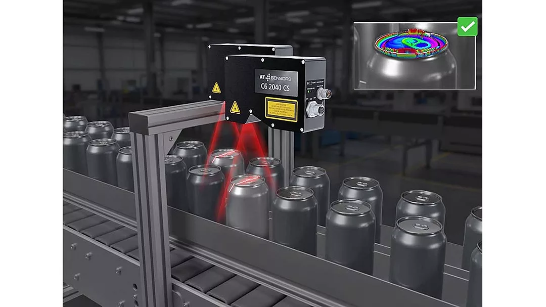

Soda can pressure check with AT-Sensors 3D laser profilers.

Alper offered a concrete example from the beverage industry. A can inspection system that scans warpage of the can top and automatically adjusts internal pressure within milliseconds can accomplish something traditional ultrasound methods cannot: 100% inspection at full production speed. The system works because it links a specific, well-understood measurement directly to a process control response in real time. The quality benefit is outsized, she said, precisely because the problem was so well defined before any equipment was selected.
