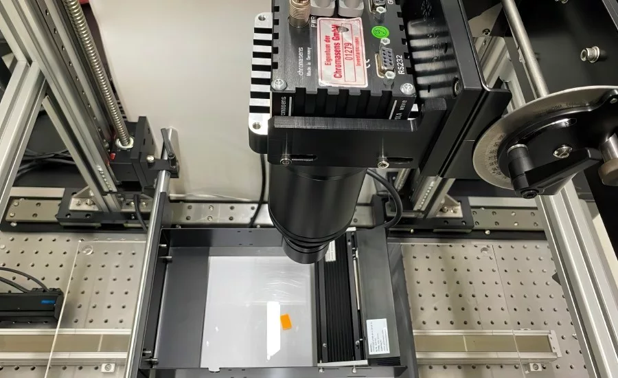

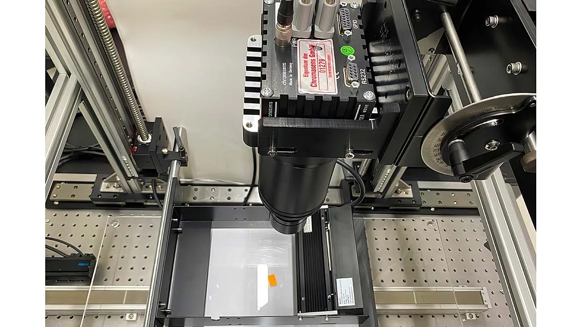

Line-scan camera inspection system mounted above a moving sample stage used for high-speed industrial quality control and machine vision applications.
Source: Allied Vision
Line scan camera captures accurate images of cosmetic defects on transparent surfaces at frequencies topping out at a maximum speed of 47.72 kHz at 850 megapixels per second.

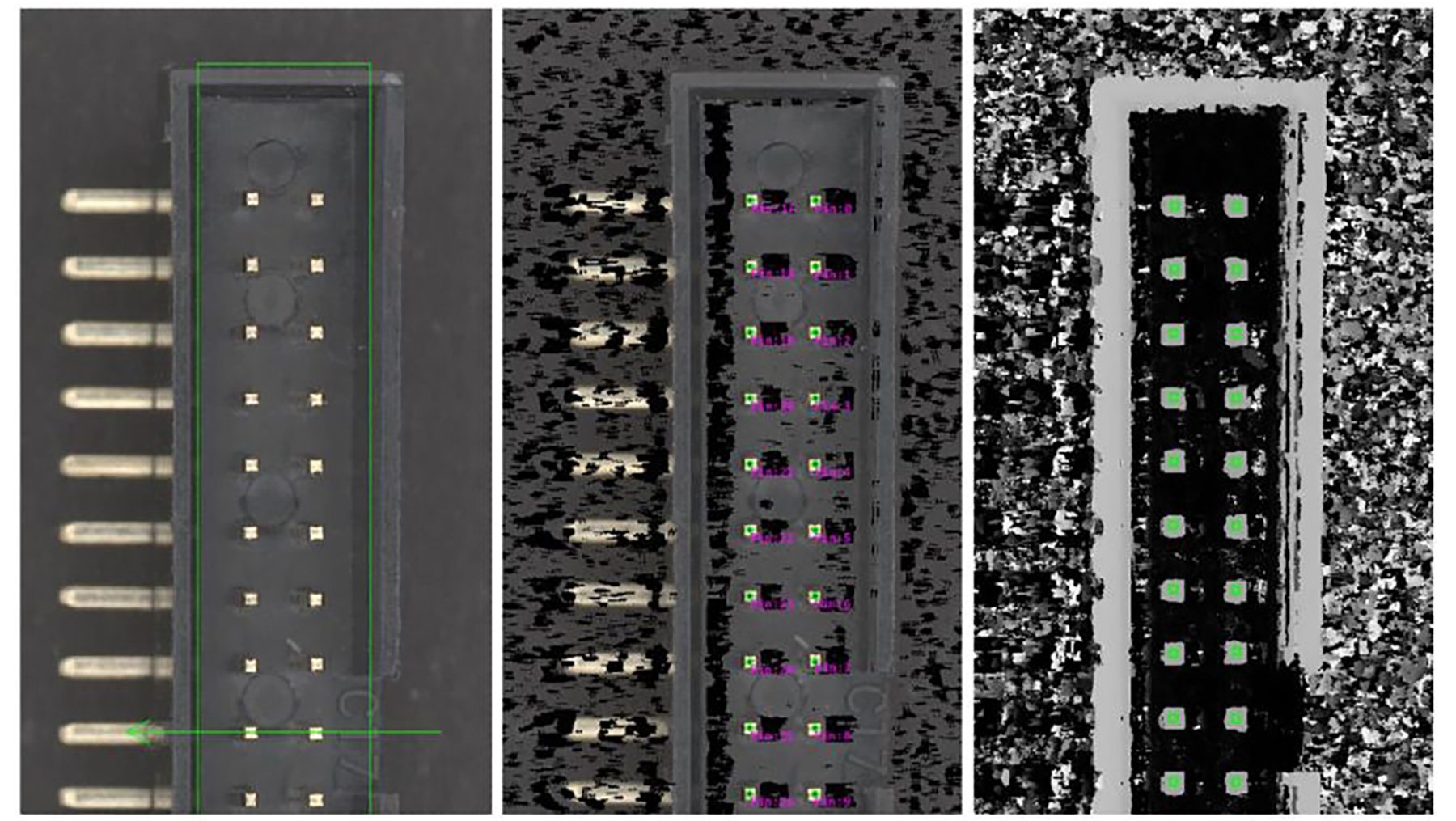

Machine vision image showing connector pins and contact pads analyzed with line-scan imaging and automated defect detection overlays.
Line-scan system uses an algorithm to detect the number of pins and creates corresponding regions of interest within a grid to calculate the 3D position of every pin relative to others while measuring pin width (radius) and length. Source: Allied Vision

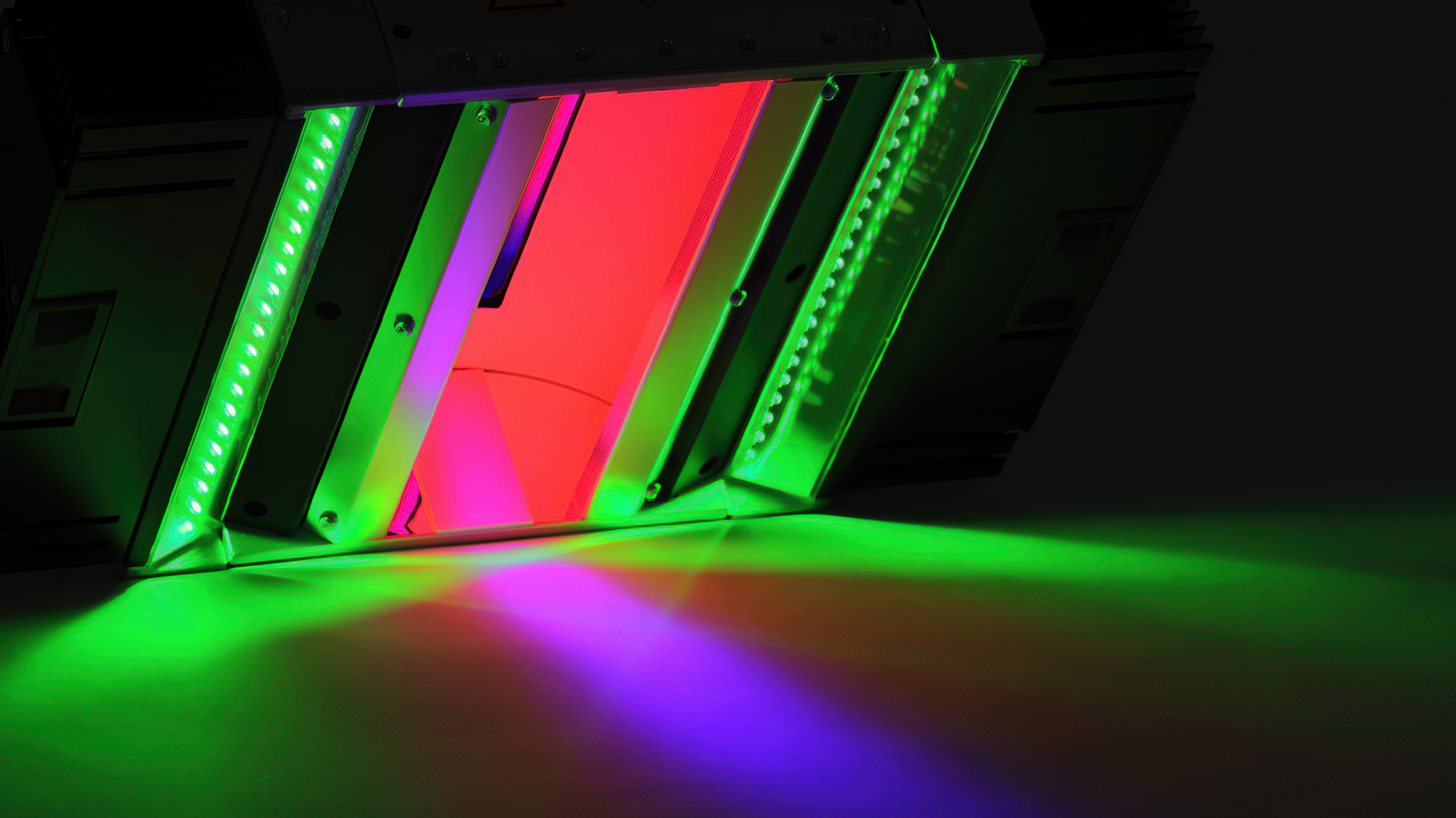

High-intensity LED line illuminator producing uniform lighting for line-scan camera inspection in industrial manufacturing environments.
Illumination intensity is mission-critical in 3D line-scan applications. As line rates climb for high-speed capture, shrinking exposure windows demand proportionally greater light output. Source: Allied Vision

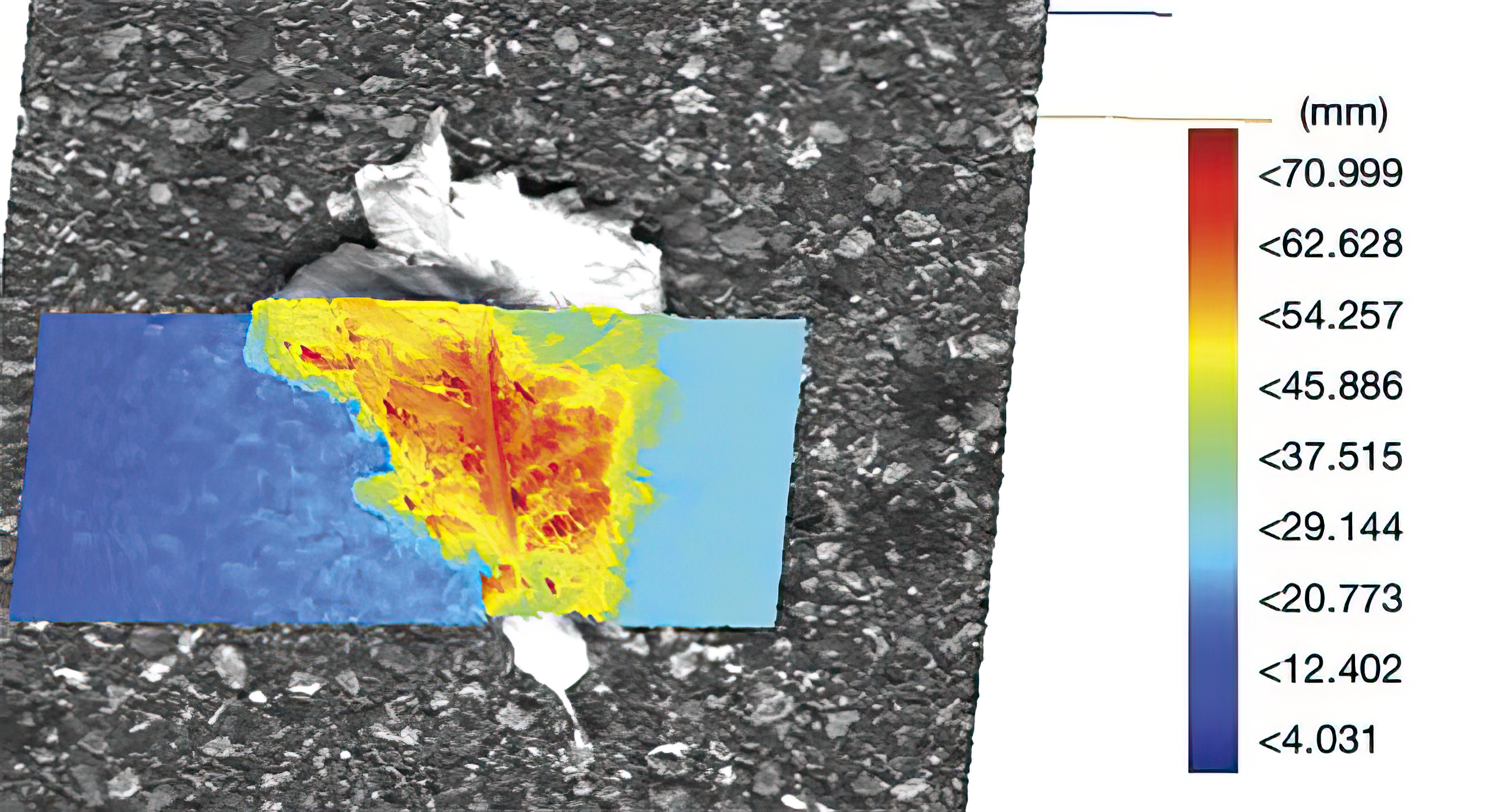

Three-dimensional surface profile visualization created from line-scan inspection data, highlighting height variations and material defects.
Line-scan 3D cameras can feature depth-sensing technology to detect road defects like potholes in real time, straight from a moving vehicle. Source: Allied Vision

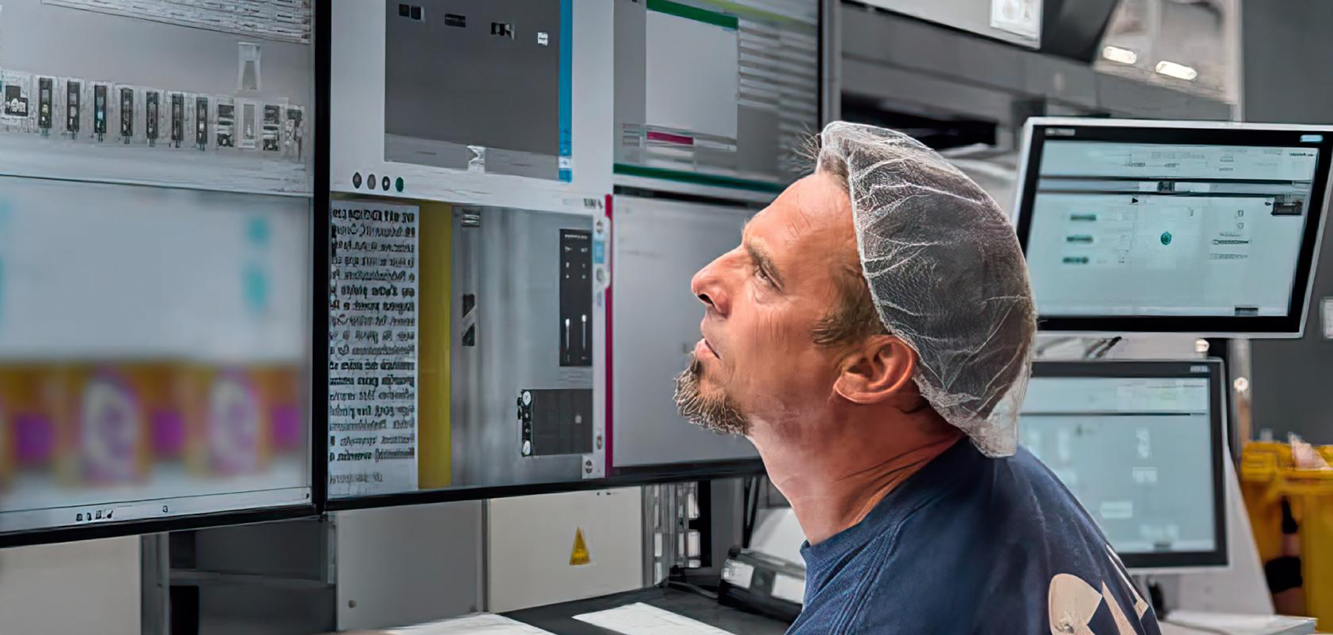

Manufacturing technician monitoring machine vision inspection results on display screens in a high-speed printing production environment.
In flexo, gravure, offset, and digital presses, the substrate moves continuously. A line-scan camera captures one thin line of pixels at a time and builds the full image as the web moves. Source: Allied Vision
