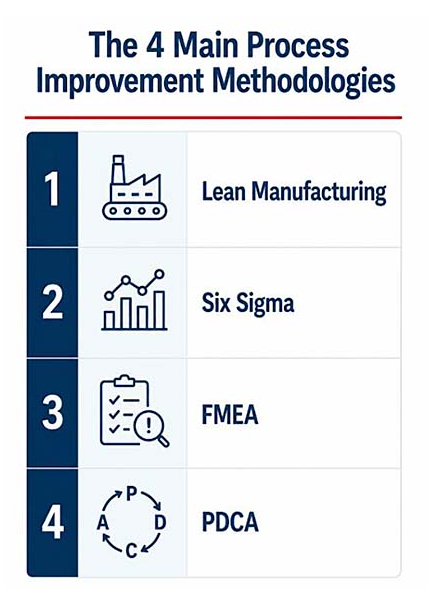

What Are the Main Process Improvement Methodologies?
For the risk mindset to move off paper, stop being just a document in a drawer, and transform delivery routines, it is essential to use tactical engineering and management tools. This is exactly where the use of process improvement methodologies becomes the vital link between risk theory and quality practice.
Improving a process essentially means understanding its behavior, eliminating its unnecessary variability, and removing its bottlenecks. A highly variable process is, by definition, a high-risk process.
Among the most consolidated methodologies and their intrinsic relationship with risk mitigation, the following stand out:
Lean Manufacturing
The Lean philosophy is premised on the systematic elimination of waste and activities that do not add value to the customer. By leaning out a process, removing excessive inventories, unnecessary movements, or waiting times, for example, the complexity where operational risks usually hide is also eliminated.
Six Sigma (DMAIC)
The Six Sigma methodology uses a strong statistical foundation—through the Define, Measure, Analyze, Improve, and Control (DMAIC) cycle—to reduce the variability of a workflow. Processes with lower variability present a much higher level of predictability, drastically reducing the risk of generating defects.
FMEA (Failure Mode and Effects Analysis)
FMEA functions as the perfect translation mechanism between risk and quality. It is an analytical tool that evaluates, step by step, how a process can fail, what the severity of the impact on the customer would be, and what the current defenses are. Based on this analysis, the quality team can prioritize preventive and corrective actions based on the Risk Priority Number (RPN).
PDCA Cycle (Plan-Do-Check-Act)
PDCA serves as the iterative engine for continuous improvement and the review of mitigation strategies. It ensures that risk assessment is never a one-time event, but rather a cyclical and adaptable process to changes in the internal and external environment.

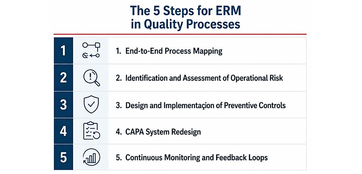

The 5 Steps for ERM in Quality Processes
1. End-to-End Process Mapping
The first step for improvement is visibility. Use process mapping techniques, such as Value Stream Mapping (VSM), to map current workflows. The objective is to visualize exactly how value flows through the organization and to identify complex intersections where operational vulnerabilities are hidden.
2. Operational Risk Identification and Assessment
With the process map in hand, conduct a rigorous assessment at each step using risk matrices or FMEA. The guiding question should be: “What can go wrong at this stage, what is the probability of it occurring, and what is the impact of the occurrence on the quality of the final product?” This step ensures that risk mitigation is specific and actionable.
3. Design and Implementation of Preventive Controls
Once the risk is identified, it is time for it to be isolated. Apply the principles of Lean and Six Sigma, for example, to design modern controls. Prioritize structural and error-proof solutions, known as Poka-yokes. If a human error is likely in an assembly stage, redesign the component so it can only be fitted in the correct way, or use digital sensors to validate the step before the process advances.
4. Overhauling the CAPA System
The Corrective and Preventive Action (CAPA) system is frequently the heart of quality management. To make it proactive, change its focus. Each corrective action generated by a root cause analysis method must not only correct the local error but must be obligatorily linked to the company’s global risk framework. If a new failure mode is discovered in production, the corporate risk register must be updated.
5. Continuous Monitoring and Feedback Loops
Risk management and quality are not projects with an end date; they are continuous disciplines. Therefore, establish rigorous audit cycles, use performance dashboards updated in real time, and keep the PDCA culture alive. This monitoring ensures that implemented preventive controls remain effective over time.
