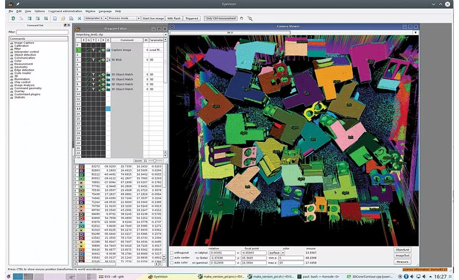

And the software to evaluate and measure in a point cloud has also developed considerably over the last few years: from only transforming image data into point clouds to measuring, counting and matching in a point cloud. So what about the ways to get 3D image data?

Nowadays there is more and more software, which can deal with 3D image data. The software can transform the captured data into point clouds, which can be compared directly and makes the analysis much easier.
