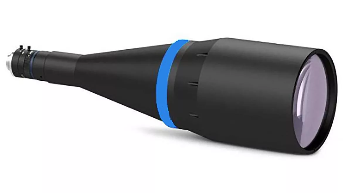

Pericentric lenses image both the top and lateral sides of a round object using a single camera.
By Joe Gugliotti
Edited picture of pericentric lens.
Image Source: R.J. Wilson, Inc. and their specialty lens manufacturer
November 24, 2024
Sometimes we need to view the top of a cylinder and just enough of the upper sides to image key features, such as the crimp or printing on the upper sides of a medical vial or short shots on the sides of an injection-molded cap. A common method of imaging the top and sides of a small cylinder involves the use of multiple cameras, arrayed with a top-down camera and up to four side-view cameras, typically placed at 90° to each other.
It’s not always possible to configure this imaging solution due to physical space limitations on the sides of the line, as well as having cylindrical containers that may lack the pitch on the conveyor to provide a clear view from each side camera.
What Kind of Image is Provided by a Pericentric Lens?
A pericentric lens provides a view of the top AND a limited vertical section of the lateral sidewalls of a cylindrical object, from the top surface downward. There are often key features that are visible on the sides of a cylindrical object within this limited height range.
The diameter and vertical height of the viewed region are dependent upon the working distance between the bottom of the lens and the top of the cylindrical object. The side view of the pericentric lens is at a maximum 24° from vertical. The following field-of-view ranges are typical of a pericentric lens:

Pericentric lenses work in 360° and specific models are compatible with 1/3”, ½”, and 2/3” camera sensors. Because the field-of-view is circular, the image circle size must fully fit within the vertical dimension of the camera sensor used. This is an important consideration when a sensor size other than one of the standard formats is used.
  • Pericentric lenses for 1/3″ sensors project a 3.6mm image circle
  • Pericentric lenses for 1/2″ sensors project a 4.8mm image circle
  • Pericentric lenses for 2/3″ sensors project a 6.6mm image circle
Note: This is different than having the lens be the same or larger format than the camera sensor size. In this case, the lens projects a fixed size image circle and it must fit within the vertical dimension of the sensor to provide a full 360° image.
