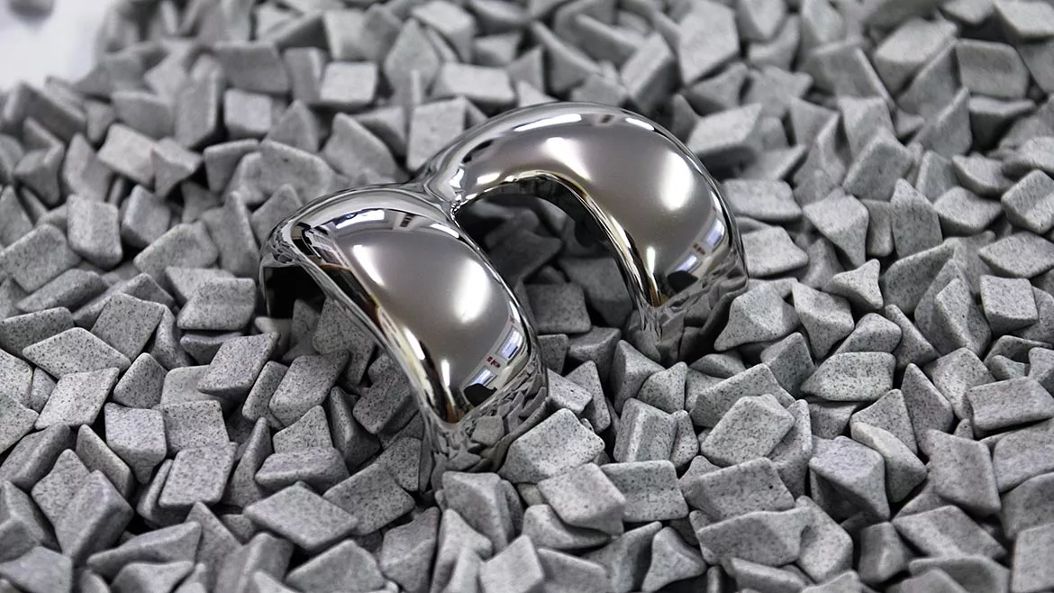

Medical part in media
Image Source: Rösler / AM Solutions

MASS FINISHING — EFFICIENCY AND PRECISION IN BULK
Mass finishing is a highly efficient and effective process for deburring, polishing, and cleaning medical parts, especially when dealing with high-volume production. This technology utilizes abrasive media in a vibratory or tumbling process to refine the surface of multiple components simultaneously. The ability to process thousands of parts at once makes mass finishing a popular choice for medical device OEMs producing surgical instruments, implantable devices, or any product that requires uniform finishing across numerous identical parts.

While the basic mechanics of mass finishing involve the movement of abrasive materials across the surface of the parts, the real advances lie in the development of specialized media, compounds, and equipment. Today, media can be precisely tailored to the material of the medical part — whether it’s stainless steel, titanium, or plastic — and can achieve a range of finishes from rough to mirror-polished, depending on the needs of the device.
For medical device manufacturers, the primary advantage of mass finishing is its ability to scale up without sacrificing quality. With consistent results across large batches, manufacturers can reduce the time and labor costs associated with manual finishing processes. Furthermore, this automation minimizes the risk of human error, ensuring that each medical part meets stringent quality standards.
However, mass finishing is not just about efficiency. Medical parts often require highly specific surface finishes to ensure optimal performance. For example, a surgical tool may need a high-gloss polish to reduce friction and improve cleaning efficiency, while an implant might require a textured surface to promote tissue integration. Modern mass finishing technologies allow for this level of customization, ensuring that the final product is both functional and biocompatible.
