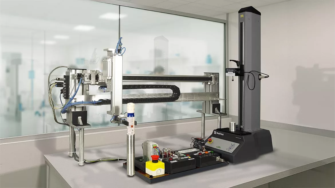

Automation compression tester sample handler aerosol.
Image Source: courtesy of Mecmesin, a PPT Group company

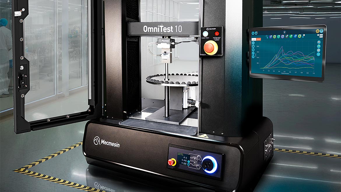

Tablet pellet crush automated OmniTest 10 full side scene in situ.
Automating the physical compression test of the samples includes the positioning, the crushing operation and rotating the platen for the next sample to align under the compression probe. Human operators load a number of specimen pellets onto the next platen for the next cycle. The software already has the built-in capability to capture the data for multiple tests and calculate graphical and tabular results according to an ASTM materials standard. Image Source: courtesy of Mecmesin, a PPT Group company

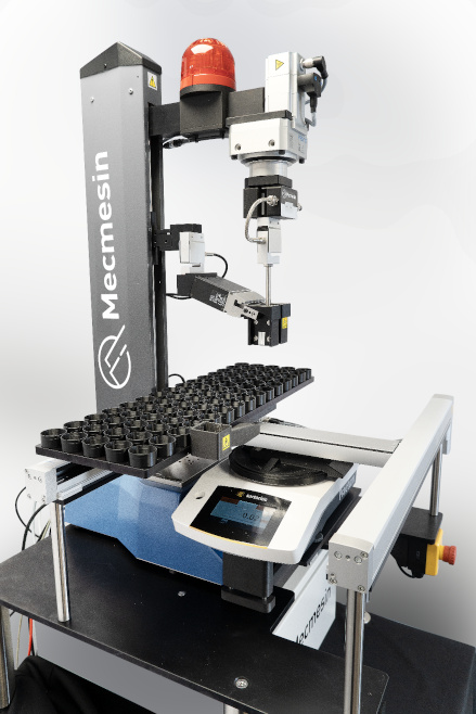

In addition to software customization, the next logical step in extending the automation capability of a test system may require changes to its physical hardware. This might include integrating robotic arms for sample handling, modifying or upgrading grips to suit automated loading, or adding sample hoppers and feeders to streamline throughput. These components work in concert with the software and PLCs to create a fully automated, repeatable testing process tailored to specific sample types and test environments.
A robotic arm and pneumatic grips.
A robotic arm and pneumatic grips synchronized with hand-picking test specimens from a tray of 75 in a single batch run. Additional outboard components (a weighing station) are connected to complete each step in this particular self-contained procedure. Image Source: courtesy of Mecmesin, a PPT Group company
