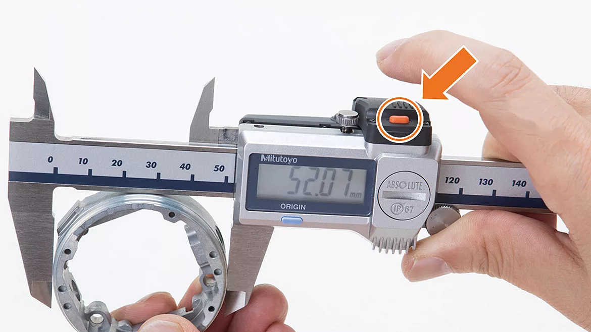

True wireless data transfer
Image Source: Mitutoyo
The greatest advantage of wireless data transfer is the elimination of cables and other equipment. A small, ergonomic transmitter on a micrometer or caliper can send measurement data to where you want and need it with a simple push of a button.
