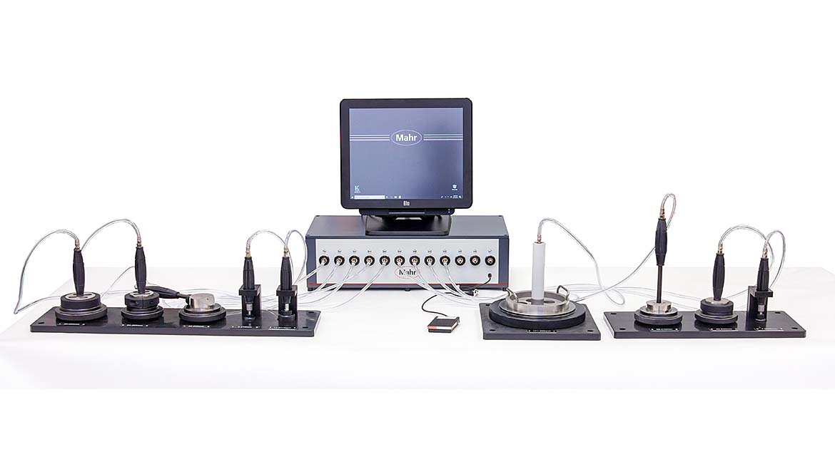

Evixmatic 20
Figure 2: Example of a portable air gaging station using air snaps, air plugs, and more.
Source: Mahr

Air gaging, while dedicated to a feature, is also versatile: it can be used in both manual and automated applications, is ideally suited for unique parts and high-volume production, and is self-cleaning with well-maintained, clean, dry air. There are options as well for multi-diameter measurements within one air tool.

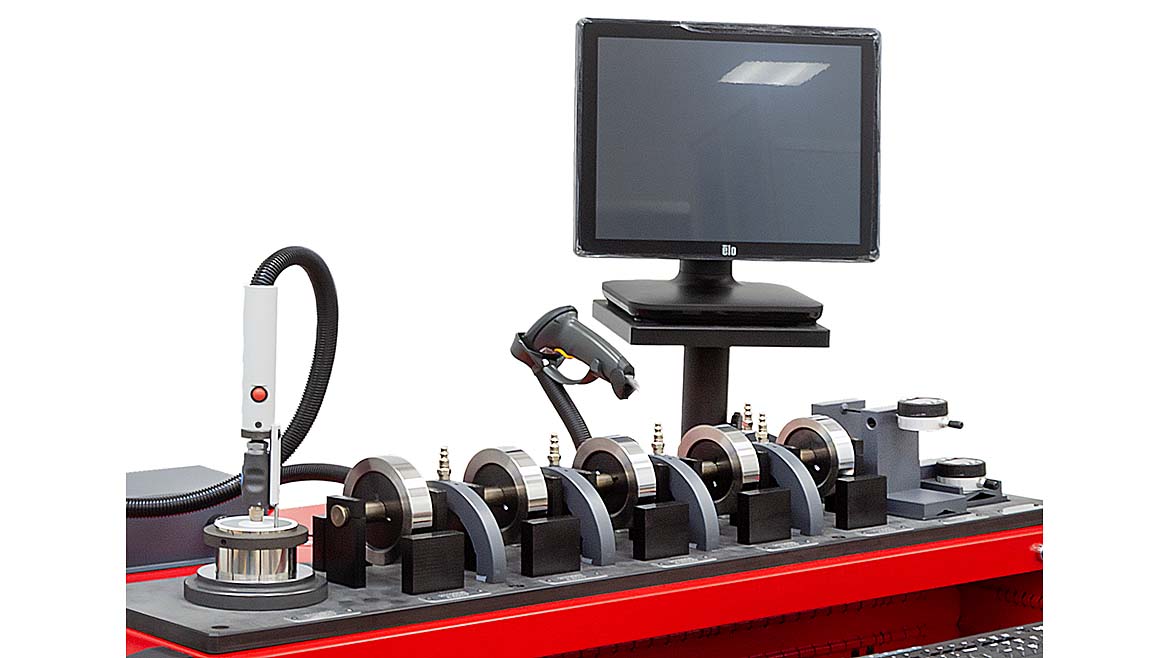

Outside diameter (OD) applications can measure shafts while still in the machine using air snaps, or inspect smaller shafts at the bench using an air ring. Thickness or width is another form of OD that can be measured by air gaging, either portable or benchtop, depending on the need. Using the combination of the two (ID & OD) can match mating parts for best-fit requirements as an assembly (as shown below). Typically, one part is measured by classification until it meets a clearance or fit requirement, and when paired, the assembly is established.
Evixmatic 20
Figure 3: Example of a match gaging station using a C1202 readout
Source: Mahr

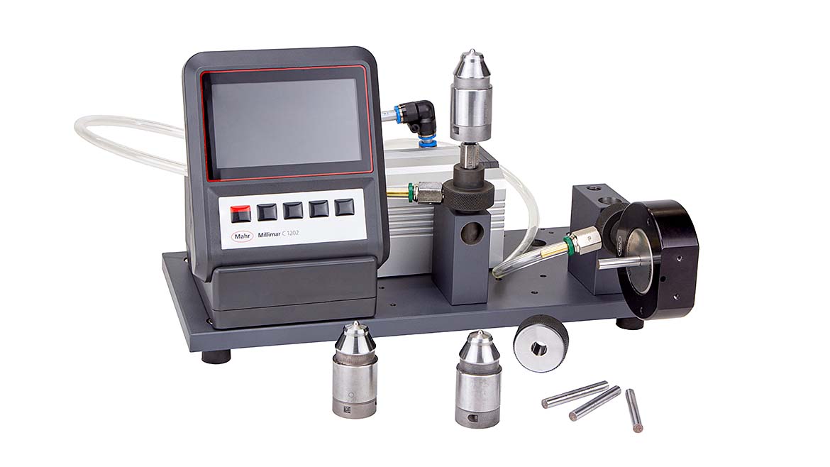

Evixmatic 20
Figure 4: Example of a multi-tool benchtop air system
Source: Mahr
Like air gaging, this discussion could go on all day long. The best way to evaluate its impact is through your specific measurement challenges. Consult with an expert to determine the ideal configuration for your facility and ensure it is the right fit for your operations.
