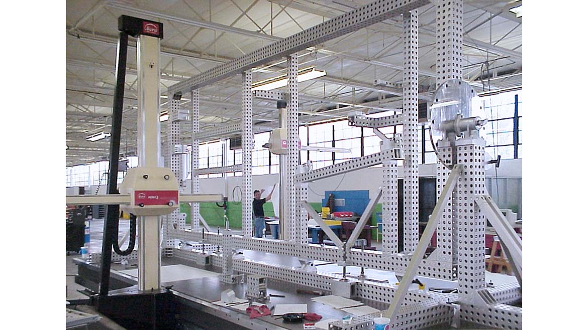

At its core, modular fixtures replace single use, custom-built fixtures with a modular system of standardized components — base plates, structural hollows, locators, clamps, and connection elements — that can be assembled and reconfigured to support virtually any aerospace part. Whether the task is CMM holding fixture requirements, welding tools, machined parts, functional tool final assembly, test or transport the same modular kit can be adapted to meet the requirement.
This flexibility is particularly important in aerospace, where manufacturers often deal with “high-mix, low-volume” (HMLV) production, complex geometries, and frequent design revisions. Rather than designing, fabricating, and storing a dedicated fixture for each part, by using a modular option, manufacturers can build a multi-purpose tool using reusable building blocks as shown in figure 1 encompassing two similar parts. The removable blocks were positioned to clamp both parts in the same frame.
a modular fixturing system
Figure 1

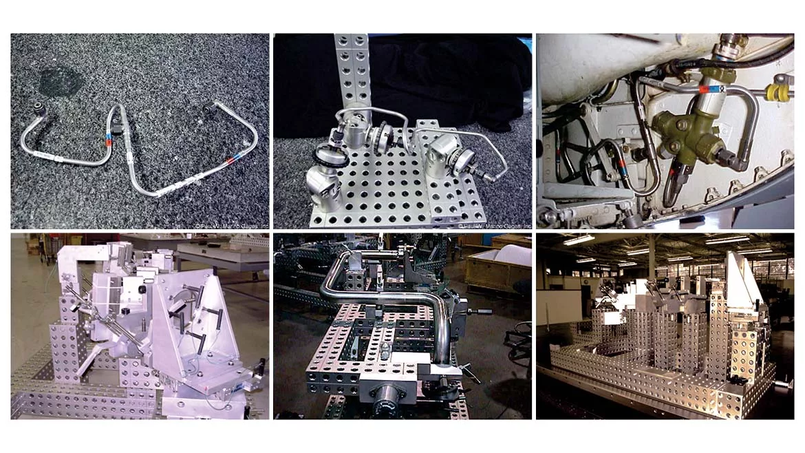

Depending on the depth of a given modular system’s components offering, fixtures can be designed and assembled for both small and large aerospace parts, from delicate components like fuel lines to complete fuselage (figure 2) or wing assembly tools (figure 3).
a modular fixturing system used for industrial manufacturing and inspection
Figure 2

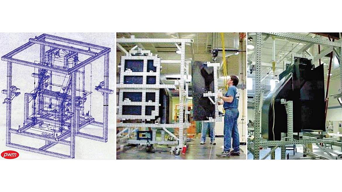

a modular fixturing system used in an industrial or manufacturing setting
Figure 3

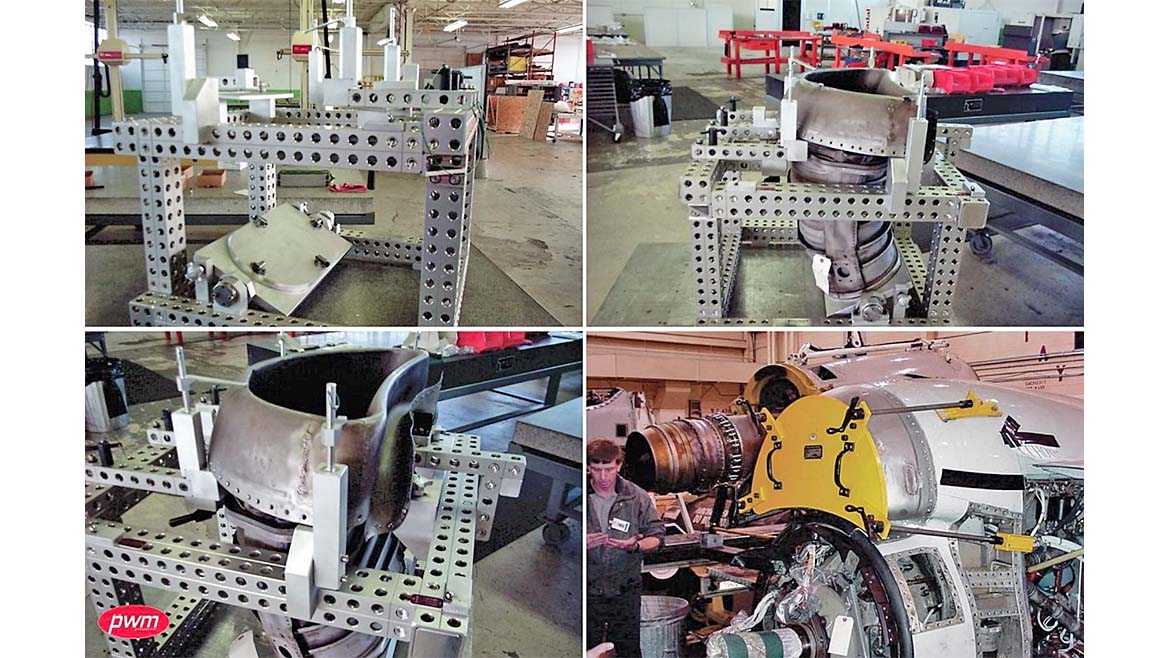

Modular tooling has been used across a variety of aerospace engine processes including orbital weld inspection of liquid oxygen (LOX) propulsion fuel lines (figure 2) and complex assembly fixtures for airframe components (figure 3) including reverse engineered duct fighter jet maintenance tools (figure 4).
Because aerospace often involves prototype work and frequent engineering model changes, the ability to modify a fixture in hours—rather than building a new one over weeks—is a major competitive advantage.
the use of American Modular Tooling (AMT) fixturing systems by Paul W. Marino Gages (PWM) for aerospace manufacturing and assembly
Figure 4

an example of industrial automation machinery, specifically a high-speed robot system designed for handling parts in manufacturing
Figure 5
Consider R&D as in “bonding tools”, like the Forward Center Fuselage (FCF, figure 5) implemented by an aerospace team targeting affordability, fabrication and assembly.
