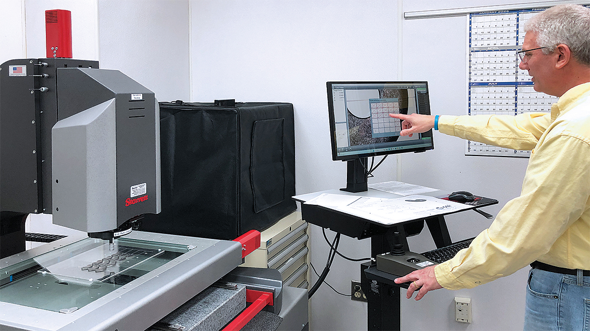

David Holland, CEI Quality Inspector, performs an efficient palletized inspection routine using automatic pattern recognition technology on stamped 'rocker' parts.
David Holland, CEI Quality Inspector, performs an efficient palletized inspection routine using automatic pattern recognition technology on stamped "rocker" parts. Image Source: Component Engineers Inc.
Rocker parts sampling set up in a palletized grid format on the Starrett AV450.
Rocker parts sampling set up in a palletized grid format on the Starrett AV450.  Image Source: Component Engineers Inc.

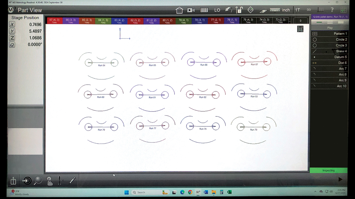

Screen view of the stamped rocker parts sampling set up in a palletized grid format.
Screen view of the stamped rocker parts sampling set up in a palletized grid format. Image Source: Component Engineers Inc.

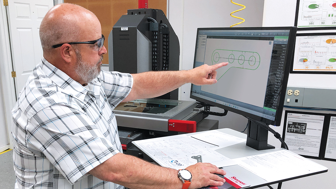

Eric Boyea, CEI Quality Manager, checking the precise profile of stamped inserts.
Eric Boyea, CEI Quality Manager, checking the precise profile of stamped "inserts".  Image Source: Component Engineers Inc.

  • Using a .dxf file for comparison of PROFILE against perfect profile per ASME Y14.5-2018
  • Easy-to-apply GD&T parameters to measurements per ASME Y14.5-2018

  • Palletizing for multi-part inspections in an "X" & "Y" grid configuration
  • Automatic pattern recognition for seamless execution of part program

Screenshot using the the Starrett AV450 and Metlogix software.
The Starrett AV450 and Metlogix software deliver faster, more reliable data, especially for profile measurements using imported .dxf files Image Source: Component Engineers Inc.

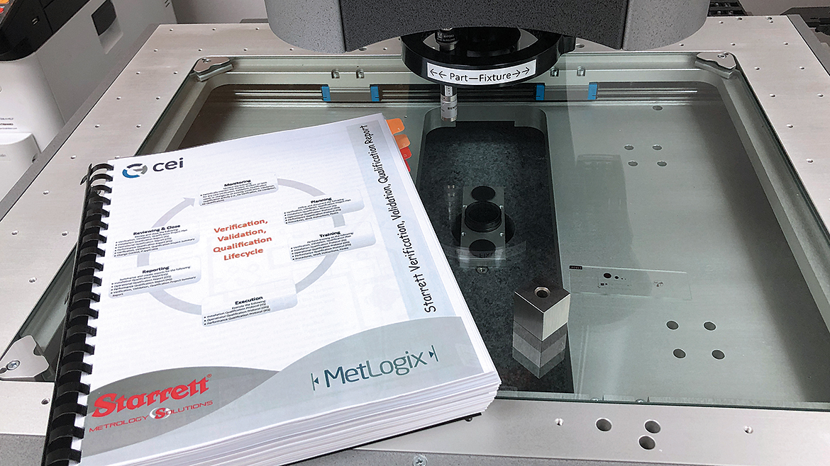

CEI created a Verification, Validation and Qualification (VVQ) plan.
CEI created a Verification, Validation and Qualification (VVQ) plan, which its Quality team executed and performed the installation, operational, and performance qualifications, producing a summary. This demonstrated that when the Starrett Vision Systems are operated as intended under normal operating conditions, they yield accurate results within stated requirements per ISO 9001:2015, ISO 13485:2016, AS 9100D, and IATF 16949:2016 standards. Image Source: Component Engineers Inc.

Quality software used to process, store, and/ or retrieve quality data for the purpose of making a pass/fail decision in a product, process, and/ or a quality metric must be verified, validated, and/or qualified (VVQ) per ISO 9001:2015, ISO 13485:2016, AS 9100D, and IATF 16949:2016 standards. Validation is required where the resulting output cannot be verified by subsequent monitoring or measurement. CEI developed and completed internal VVQ activities based on the standards it is certified/compliant to for its new and legacy Starrett systems, including MetLogix M3, Heidenhain QC5000, and Heidenhain IK5000 software. These activities were completed in February 2025, ensuring that all of the Starrett Vision Systems yield accurate, repeatable results when used in decision-making. "Our VVQ strategy is built around the 6Ms of production strategy: Man, Machine, Material, Method, Measure, and Milieu (Environment)," Boyea explained. "We created the VVQ plan, executed and performed the installation, operational, and performance qualifications, and summarized the VVQ, demonstrating that when the five Starrett Vision Systems, including the legacy systems and new AV450’s, are operated as intended under normal operating conditions, they yield accurate results within stated requirements," said Boyea.
