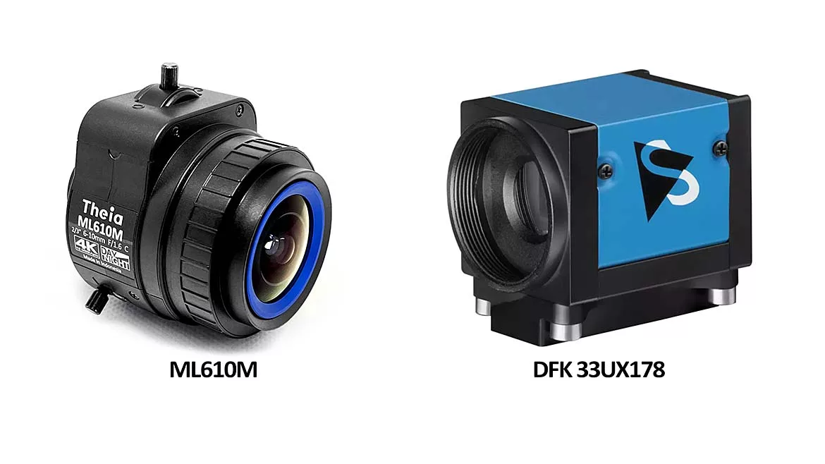

Fig. 1. The vision system included Theia’s ML610M and The Imaging Source’s DFK 33UX178, creating a high-resolution 200lp/mm vision system.

When The Imaging Source set out to implement a high-precision optical character recognition (OCR) system for industrial imaging, Applications Engineer Tommie Minor turned to a combination of Theia Technologies’ ML610M varifocal lens, The Imaging Source DFK 33UX178 camera, and Zebra’s Aurora Vision Studio software platform with its Deep Learning OCR tool. The objective was to achieve fast, accurate recognition of small characters at a close working distance of roughly nine inches (~23 cm), even in demanding industrial environments. Reliable OCR is critical for applications such as product serialization, label verification, electronics inspection, and automated traceability, where even minor misreads can disrupt production, compliance, or quality control.
Central to the system’s success was Theia’s ML610M 2/3″ format varifocal lens, designed for a 1.55 µm pixel size to resolve detail up to 300 line pairs per millimeter contrast. This exceptionally high resolving power ensured that the fine strokes of small, densely printed characters remained sharp and distinguishable when projected onto the camera sensor. In OCR tasks, where the difference between a “1” and a lowercase “l” or a “5” and an “S” can determine whether a code is read correctly, maintaining edge contrast at the smallest character scales was critical. The lens’s true 4K, 12-megapixel optical design, combined with aerospace-standard sweep vibration resistance from 20 Hz to 200 Hz to 20 Hz at 10 G for 30 minutes per axis and IR correction from 440 to 940 nm, ensured crisp images across variable lighting and industrial operating conditions (Fig. 1).

The DFK 33UX178 camera features a 2/3″ format, 6.3-megapixel sensor with 2.4 µm pixels, making it a strong match for the ML610M’s Ø11 mm image circle and 300 lp/mm optical capabilities. Although the lens itself can resolve up to 300 lp/mm, the system’s effective resolution is limited by the camera to 200 lp/mm. Even at this level, the pairing delivers exceptionally crisp, edge-to-edge detail across the entire sensor. At a nine-inch working distance, it produced a dense, high-contrast pixel grid that captured even the thinnest strokes with minimal blur.
