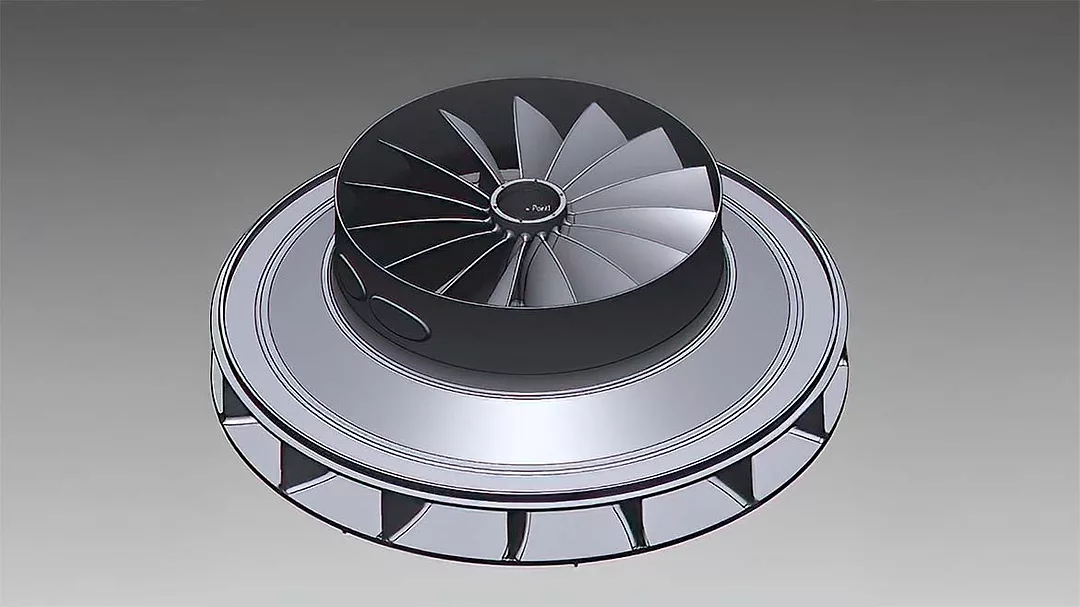

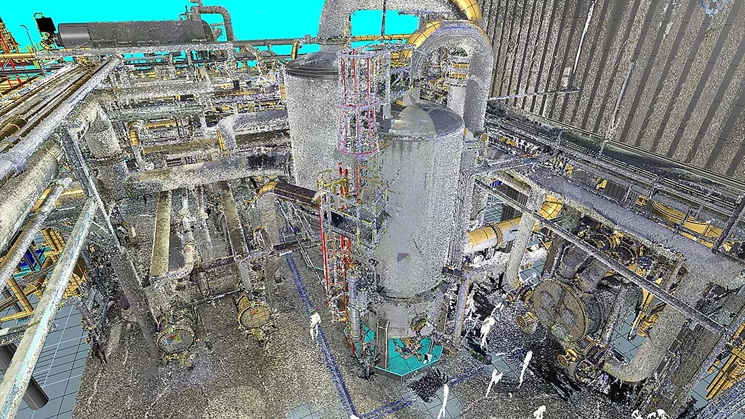

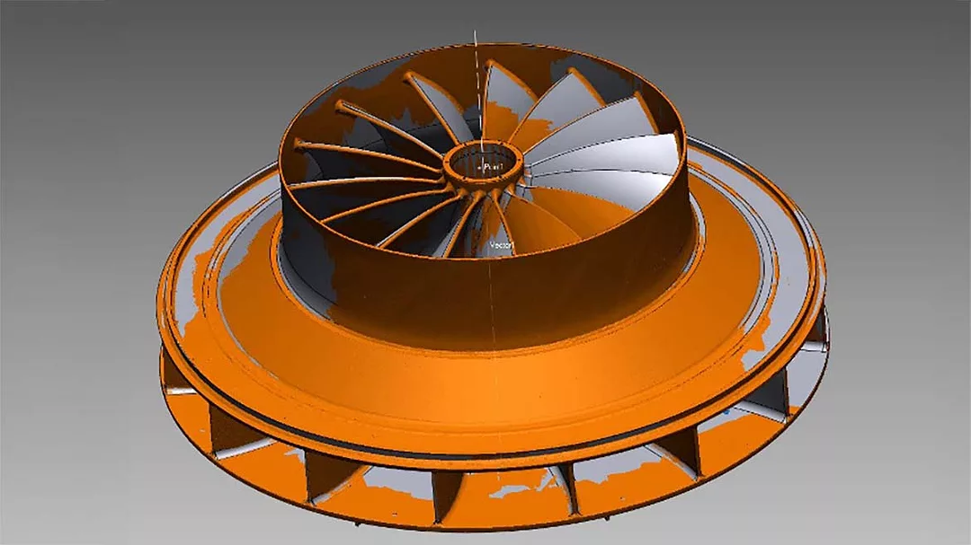

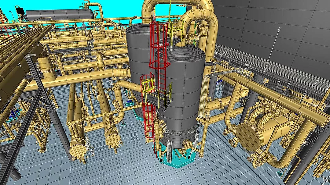

When a part, area, or entire facility is scanned and an “as-is” CAD model is created, the result is a high-fidelity digital representation of that object at a specific moment in time. It’s a snapshot. These models are invaluable for inspection, reverse engineering, or design reference because they capture exactly what the part looked like the day it was measured.

  • 3D scanning and modeling capture complex geometries and as-found or as-left conditions.
