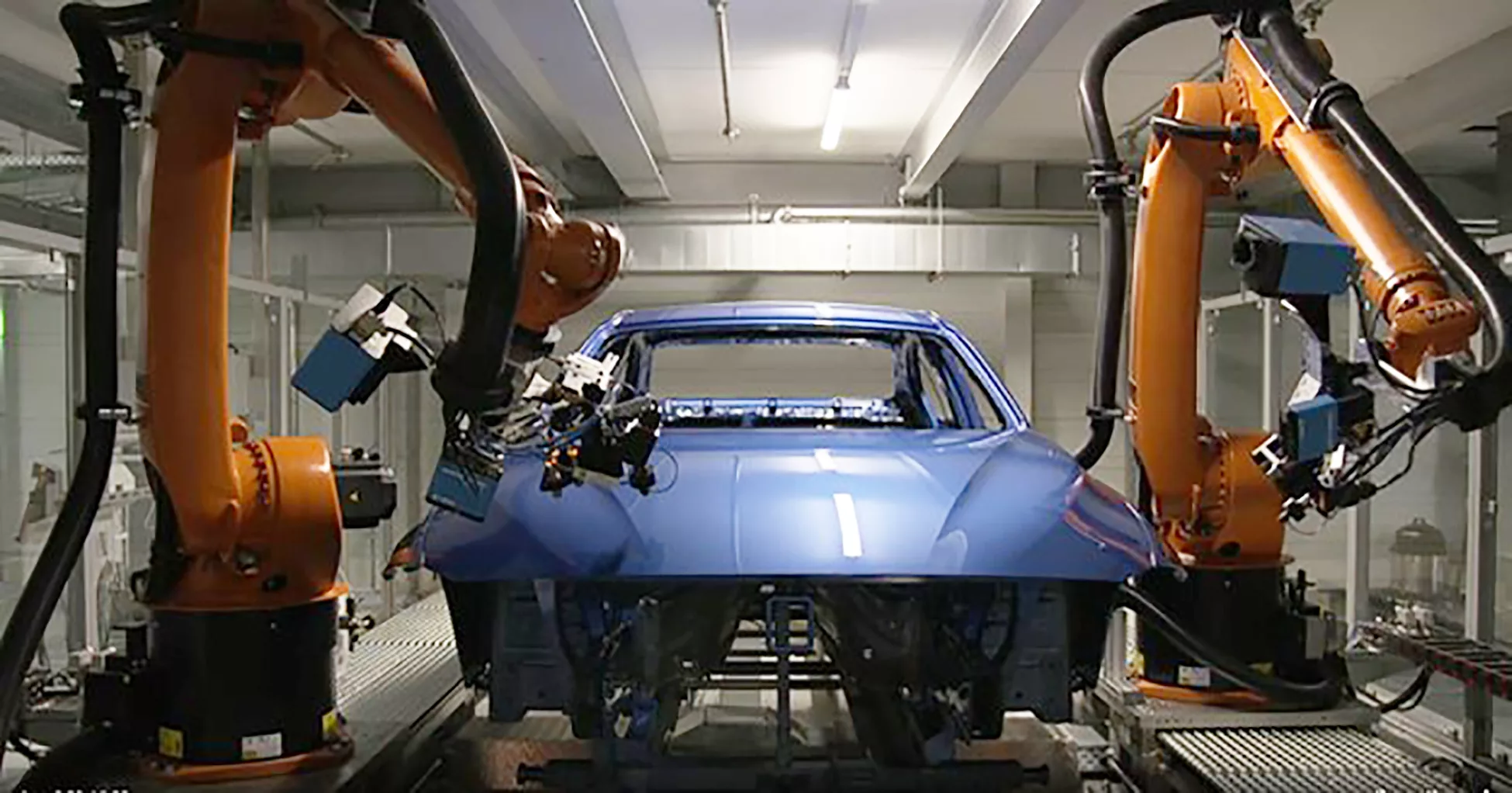

This image shows an automated automotive production line utilizing KUKA robots for surface processing and quality control on a vehicle body.

Even with the best control of measurement procedures, there is still potential for measurement errors to occur. For this reason, the implementation of robotic solutions is becoming more popular. Robotic solutions enable more precise measurements and the collection of additional data. Larger data sets reveal patterns in process variation, enabling faster responses to changes in process parameters and enhanced quality. Robotic solutions are best suited for processes that consistently produce the same product on a daily basis. For processes with high variability, where the product or parts change frequently, handheld instrumentation is often the preferred approach. Most importantly, there should be excellent inter-instrument agreement between handheld and robotic versions of color and appearance instrumentation, as well as nondestructive multi-layer film build analysis.
