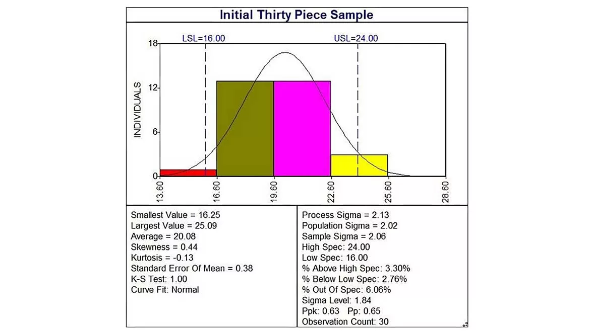

Initial Thirty-Piece Sample
Charts by Quality America, Inc. SPC-PC IV Explorer / SPC IV Excel
Figure 1: Initial Thirty-Piece Sample
February 26, 2026
A process was, on an irregular basis, failing to meet the mark, perhaps 5% of the time. The process engineer observed the process in action and took a sample of thirty parts for analysis. The process performance index Ppk was estimated at 0.64, as shown in the histogram of Figure 1, which corresponds to approximately 6% out of specification, supporting the original concern for attention.

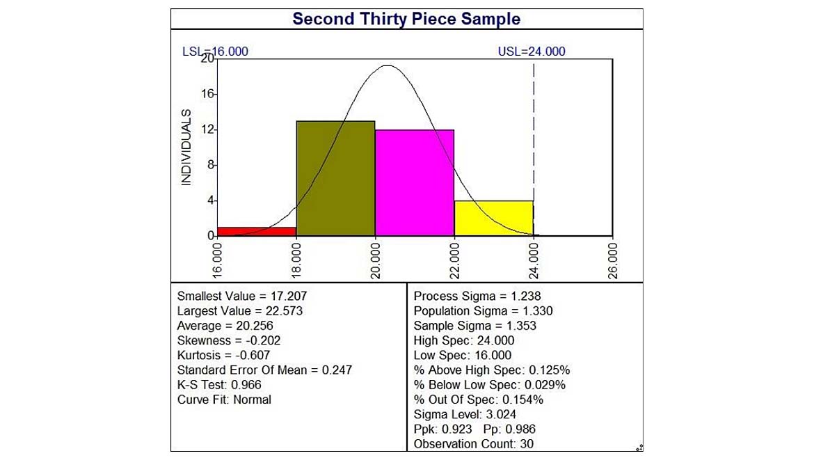

Based on the process observations and the analysis of the collected data, the analyst concluded that the process operators were not following the established process protocols, leading to process deviations. A training session was scheduled and conducted, emphasizing the need for process operators to heed the best practices documented in the process procedures. A subsequent analysis of the process post-training, again with a sample of 30 measurements, indicated the process performance had improved to 0.92 (Figure 2), a noticeable improvement that dropped the error rate well below 1%. Backs were patted for a job well done.
Second Thirty-Piece Sample
Figure 2: Second Thirty-Piece Sample

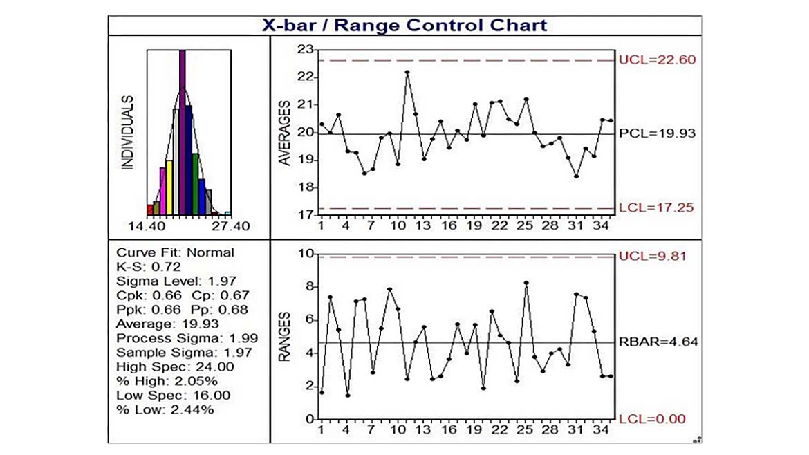

The control chart for the above process is shown in Figure 3. Subgroup 3 on the chart consists of the first five measurements from the initial thirty-piece sample discussed above; subgroup 14 is the first five measurements from the second thirty-piece sample.
X-bar Range Control Chart
Figure 3: X-bar Range Control Chart
(Charts by Quality America, Inc. SPC-PC IV Explorer / SPC IV Excel)
The control chart portion of Figure 3 consists of an Averages (or Xbar) chart (to the right of the histogram), and a Ranges chart (beneath the Averages chart and to the right of the summary statistics). The Xbar chart plots the average of each five-piece subgroup randomly collected at each sample period, which might be an hour, day, or month worth of production, depending on the production frequency and the criticality of the process. The Range chart plots the range or difference between the largest and smallest measurement in the five-piece subgroup. The Xbar and Range charts each have an Upper Control Limit (UCL) and a Lower Control Limit (LCL). These control limits are calculated based on the average and/or range statistics of the plotted data.
The control charts in Figure 3 show a process in control: all plotted subgroups on each chart are within their respective control limits. There are no subgroups plotted beyond the control limits. The central tendency or location of the process, estimated by the average, is stable, as is its dispersion or variation, estimated by the range.
A stable process is predictable. Since this process is in control, the expected bounds of the plotted statistics (the subgroup average and the subgroup range) are defined by their respective control limits. We can predict this process will continue to behave similarly, until it is changed. The Process Capability statistic, Cpk, shown in the Figure as 0.66, is used for stable (i.e. in control) processes. Since this Cpk is less than the often-cited minimum of 1.33, we predict this process will fail to meet requirements unless it is changed. (Note that some customers require a minimum Cpk of 1.67 to assert the process is capable).
A statistically significant change to the process would generally be evident by a plotted subgroup outside of the control limits. (Generally only because it may take more than one subgroup to detect the change, depending on the relative magnitude of the change). An out-of-control process cannot be predicted: It is unstable, and until the cause of the instability is identified and removed you cannot predict when it will reoccur.
Since the control chart of Figure 3 shows a controlled process, we see no evidence of a process change as suggested by the second 30-piece population sample (coinciding with subgroup 14). The differences in the sample average and range between the first and second 30-piece samples reflected random (aka common cause) variation in the process, which we could not measure with the population-specific samples we took earlier. There are zero out of control conditions, which would indicate a process change, near subgroup 14, so the training provided no noticeable effect.
