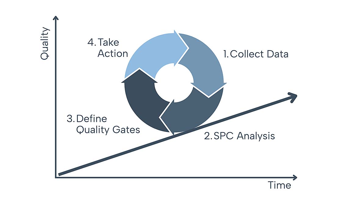

THE IMPROVEMENT LOOP
This is where traceability becomes more than a compliance asset. It becomes the foundation of an operational improvement loop (see Figure 2). A mature AM production loop looks like this:
  1. Collect Data: Traceability links powder → process → post-processing → inspection at part level.
  2. SPC analyses those connected datasets to understand key quality influences and likely root causes for drift.
  3. Quality gates are defined and monitored to detect growing variability early.
  4. Actions are taken (and then verified) to continuously improve the production process.
At that point, the digital thread stops being a passive archive. It becomes a tool for controlling variation and improving yield. This is the difference between knowing what happened and being able to influence what happens next.
Improvement-Loop for quality
Figure 2: Improvement-Loop for Quality through SPC. Source: amsight

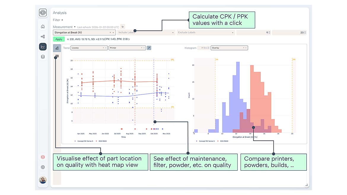

An example of this kind of insight is using built-in analytics to understand the effect of part positioning on surface roughness or dimensional behavior across a build. If your data is structured, you can see trends across repeated jobs rather than relying on anecdote. That’s exactly the kind of operational learning that reduces scrap over time (see Figure 3).
Example of SPC-Analytics in amsight
Figure 3: Example of SPC-Analytics in amsight: Monitor quality over time; compare different printer, powder batches or builds; and see the effect of machine status on quality. Source: amsight
