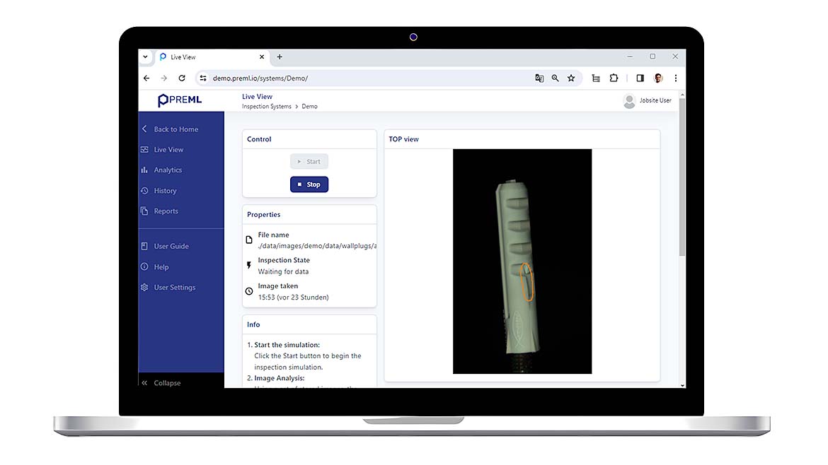

A closer look at real‑world inspection: Live results in seconds
Modern AI‑based inspection systems provide immediate visibility during operation. Relevant areas are highlighted in real time, potential defects are marked, and images are recorded automatically during inspection. Results are available as the process runs, without waiting for offline analysis. This enables faster responses and supports confidence in the inspection process.
Machine‑learning‑based inspection
Machine‑learning‑based inspection can detect subtle surface variations on molded plastic components that often evade rule‑based systems.
Source: IDS
This type of live feedback is particularly useful during changeovers or ramp‑up phases. Operators see right away whether the inspection model reacts as intended when a new product is introduced or when process parameters shift slightly. That shortens the path from trial to stable series production.

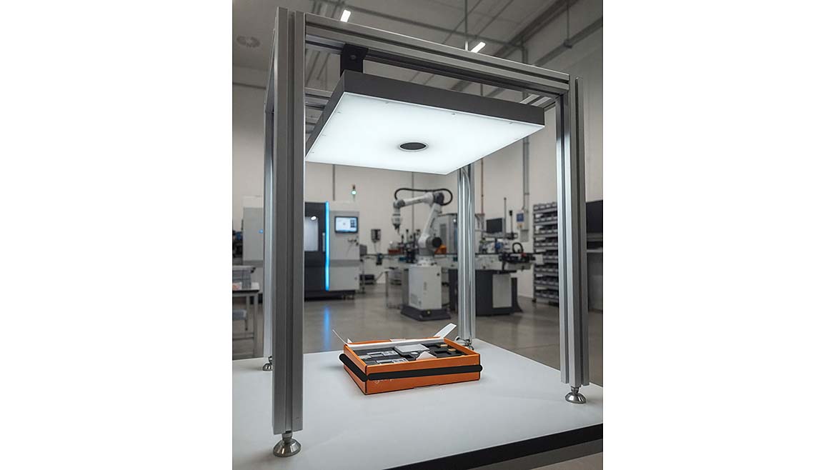

Reproducible conditions: the importance of a stable optical setup
AI models perform best when imaging conditions are consistent. Well‑designed inspection stations contribute to this stability. Uniform, diffuse lighting helps ensure consistent surface appearance, while a fixed overhead camera reduces variation caused by alignment or height differences. A rigid mechanical structure maintains stable geometry across shifts and operators.
Modular inspection systems
Modular inspection systems combine uniform illumination and overhead imaging to provide stable conditions for machine learning based evaluation — even when product geometries or lighting environments change.
Source: IDS
Such setups provide the predictability required for reliable machine‑learning‑based evaluation and reduce dependence on precise mechanical positioning of each part. Even when surrounding conditions change, the inspection volume remains controlled and repeatable.
