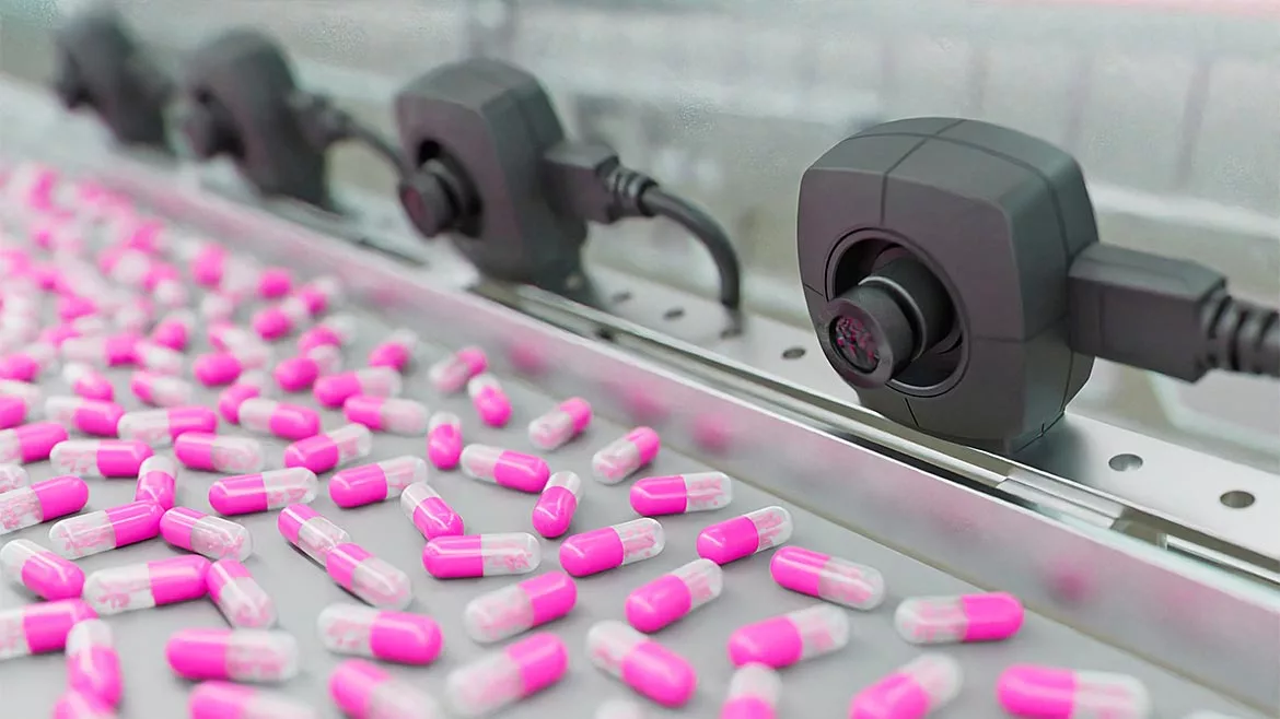

Counting capsules on a conveyor belt.

Consider the task of counting objects—a common machine vision application. Event-based cameras excel in counting fast-moving items, such as cascading parts. Their fine temporal and spatial resolution allows precise tracking of moving objects by detecting transitions pixel by pixel. Image-based cameras struggle in such scenarios, where objects may skip across several pixels between frames. For example, a pharmaceutical company might use event-based cameras to count pills dispensed into bottles, ensuring accuracy at high speeds.
