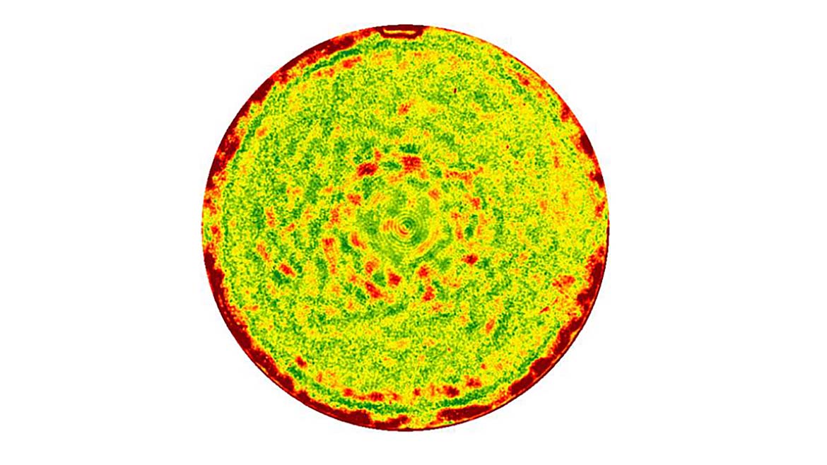

Surface topography map of a non-polished semiconductor wafer.
Source: Mahr
Example of a CMP Non-Polished Wafer

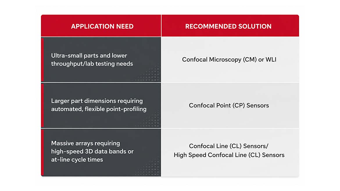

The Selection Framework
When evaluating the right tool for a specific workflow, a general rule of thumb applies to the selection process:
Table matching measurement applications with recommended confocal inspection technologies.
Source: Mahr
By matching the optical sensor to throughput and geometric needs, manufacturers can successfully move advanced optical tools out of the lab and into fully automated, high-yield production workflows.

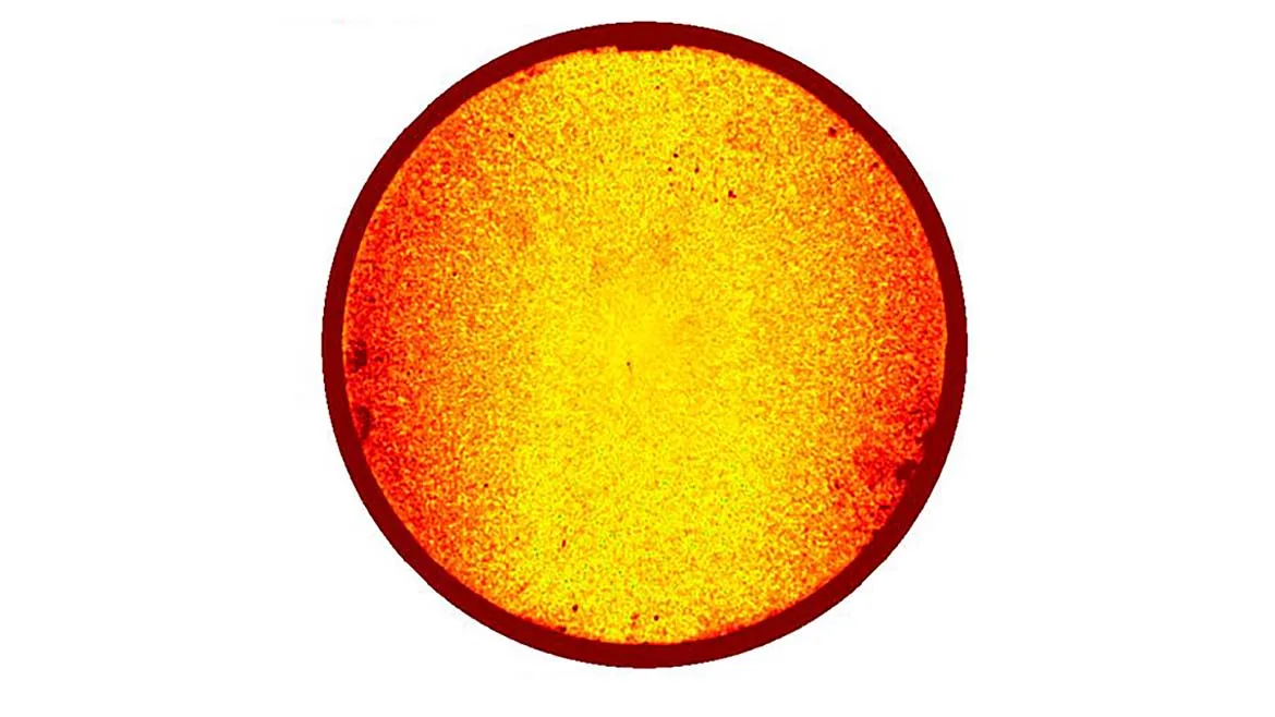

Example of a CMP Polished Wafer. Source: Mahr
