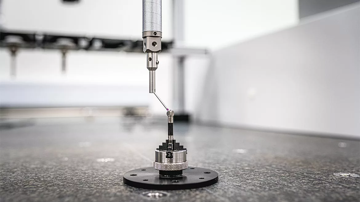

ZEISS Special Styli - Swivel Probe
Application: Using the right styli supports accurate and reproducible measuring processes and can significantly reduce measuring time. Image courtesy of ZEISS Industrial Quality Solutions
