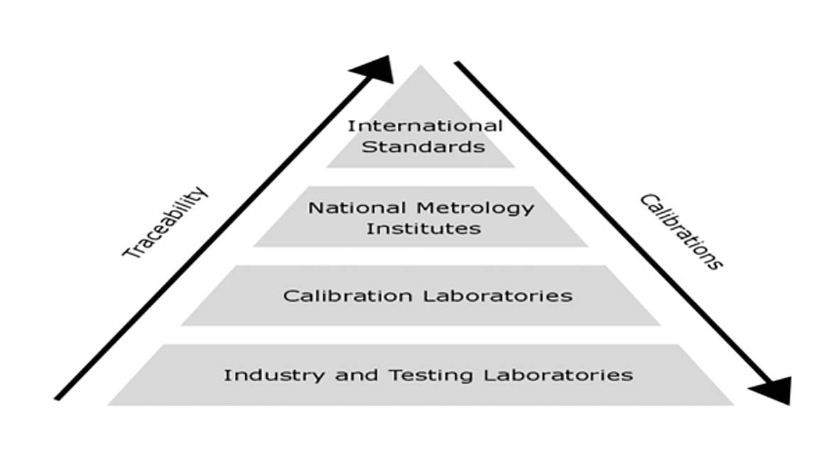

Calibration/Metrological Traceability Chain in Practice:
In calibration, the metrological traceability is a fundamental consideration. The metrological traceability in calibration can be presented as a pyramid. The pyramid illustrates how the different levels in the traceability are located. As all your industry and testing laboratories are located in the lowest level, their traceability is dependent on all the levels above the industry and testing laboratories.
Calibration/Metrological Traceability Chain pyramid of how the different levels in the traceability are located.
Source: BIPM
If the calibrations you perform in your laboratory are not traceable, you do not know if they are correct or not and therefore, there is really no point in doing them. All the calibrations in the traceability chain have to be done at regular intervals. It is not enough that you once have had your reference standard calibrated and then you continue using it for years without re-calibrations. The calibration of any measurement device only remains valid for a stated period of time. Therefore, the traceability expires when the calibration expires.
