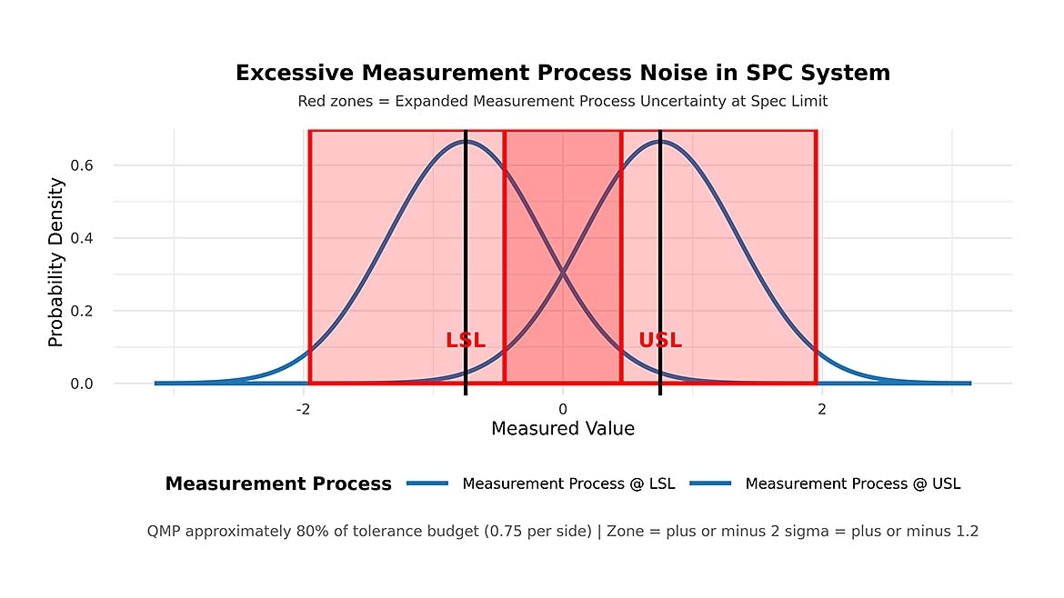

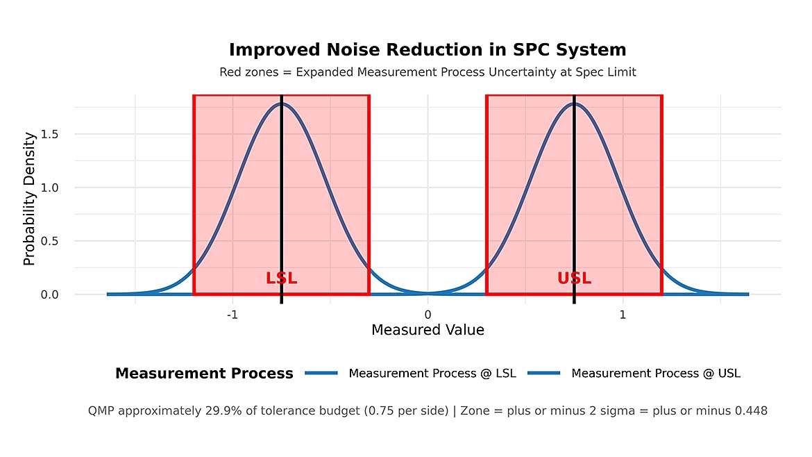

Excess noise in the SPC system makes analysis and problem solving more difficult because it can become harder to determine whether a part is actually passing or failing in many situations. In mass production, the excess noise in the SPC system can cause major problems for quality and production workers trying to meet strict requirements and short deadlines.

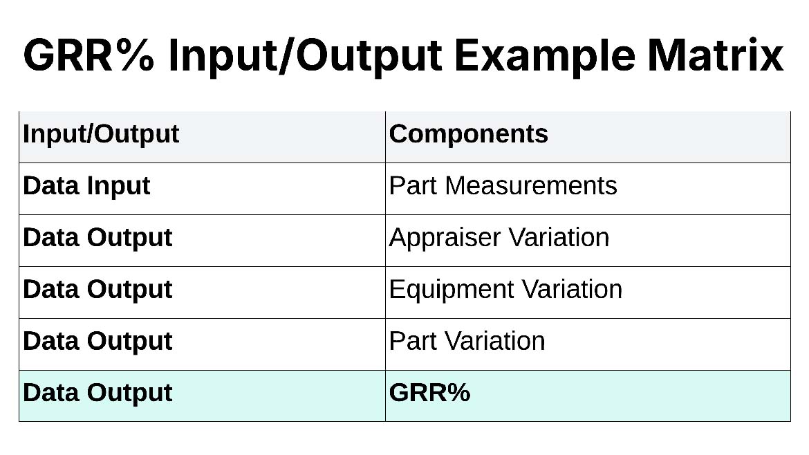

The Automotive Industry Action Group developed a handbook for conducting Measurement System Analysis which has been used as a guide for not just the automotive industry, but other industries as well. Most auditors and OEM suppliers use a metric called GRR% to measure how much variation the measurement system is generating. The most common test is to use 10 parts, 3 operators, and 3 trials as the data inputs. The output tells you how much of the variation of the measurement system is caused by repeatability, reproducibility, and the parts themselves. By doing analysis, you can break the variation down into separate components to determine if the equipment or the operators are causing excessive variation. The GRR% target of less than 10% has been codified across many different standard operating procedures worldwide.
 table titled
Source: Dan Lay Jr.
The handbook goes well beyond a simple GRR%. It covers linearity, bias, stability, and destructive testing, but GRR% only covers repeatability and reproducibility. It doesn’t aggregate everything into one decision metric, and it doesn’t capture temperature influences or account for testing or calibration uncertainties from the labs.

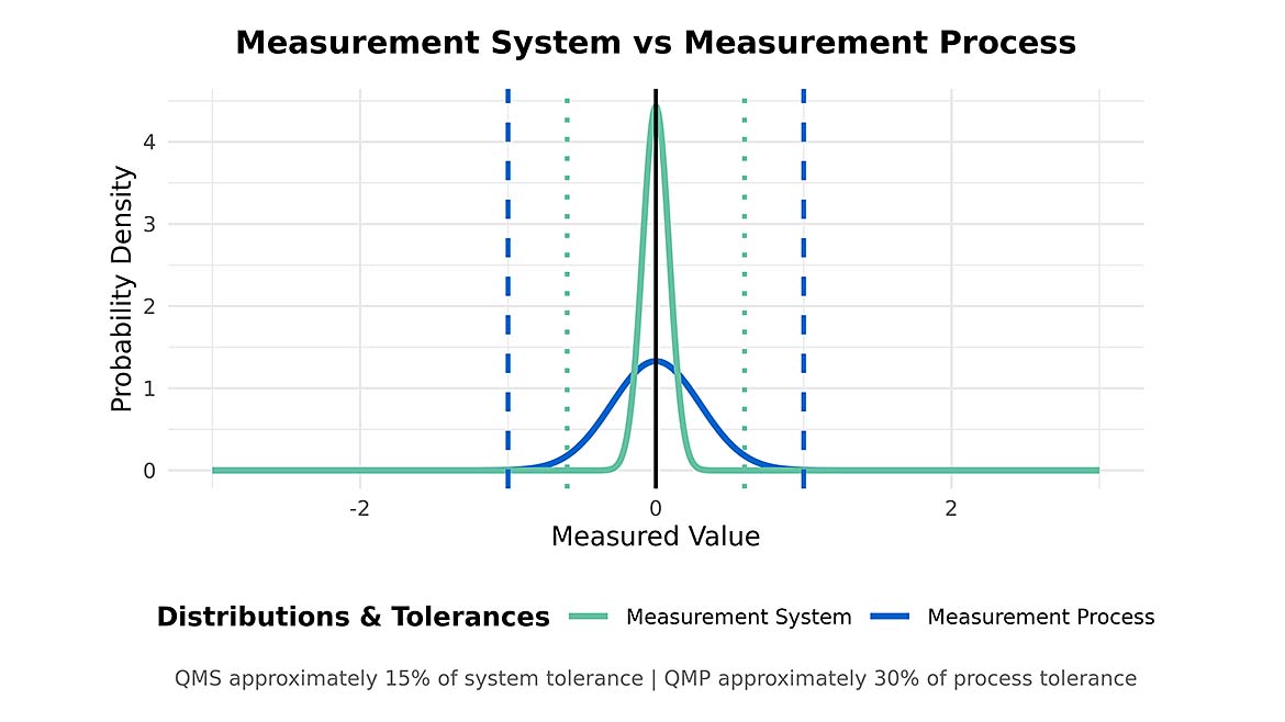

Minimum Tolerance Testing
VDA5 lets you take the inputs from your uncertainty budget and run them in reverse to get a minimum tolerance for both the measurement system and the measurement process. The common acceptance limits are that measurement uncertainty should consume up to 15% of the measurement system and 30% of the measurement process.
Here is how it works: You pull the expanded uncertainty from your budget (k=2) and solve for the smallest tolerance that still meets the limit.
Minimum Tolerance of the Measurement System = Uncertainty of Measurement System / 0.15
Minimum Tolerance of the Measurement Process = Uncertainty of Measurement Process / 0.30
a conceptual diagram illustrating the difference between a measurement system and a measurement process
Source: Dan Lay Jr.
If the tolerances on the drawing are smaller than the calculated minimum tolerances, there could be measurement problems once it goes to production. At this point you would flag the process for further review rather than sending it to mass production.
