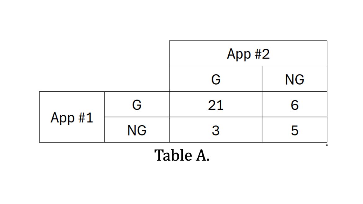

Let’s consider a case study in which two appraisers evaluate an attribute gage pin by each measuring the same 35 samples and comparing their results. Each appraiser declares each of the 35 samples as either “G” or “NG” on the basis of the output of the attribute gage. A useful presentation of the study data follows:

In our case study, the appraisers agreed 21 times that the sample was Good (nGG) and five times that the sample was Not Good (nNGNG) for a total of 26 points of agreement in 35 opportunities (N) yielding an observed agreement (Po) of,
Po = (21 + 5) / 35 = 74.3%

PG = ((21 + 6) / 35) * ((21 + 3) / 35) = .529
PNG = ((3 + 5) / 35) * ((6 + 5) / 35) = .072
Pe = .529 + .072 = .601

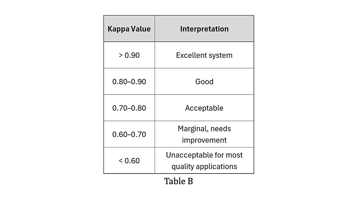

A quality engineer’s interpretation of Kappa will vary with industry and application, but a good starting point for interpreting values of Kappa can be found in Table B.

A Kappa of 1 implies perfect agreement. A Kappa of 0 implies no agreement beyond what chance produces. Kappa calculation can also produce negative values (i.e. worse than chance) implying systematic disagreement. This unusual case is typically caused by a structural problem with the inspection process e.g. a misunderstanding about what is G and NG, recording data incorrectly, etc.
In our case, even though the inspectors agree 74.3% of the time, once chance agreement is removed, the true agreement is only 35.6%, an unacceptable result in most environments.
