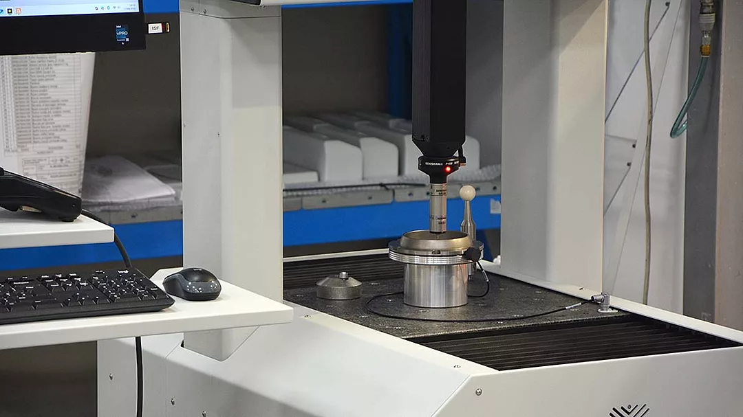

The image displays a Coordinate Measuring Machine (CMM), a specialized tool used for precise inspection and dimensional verification of manufactured parts.
Source: Ready Metrology

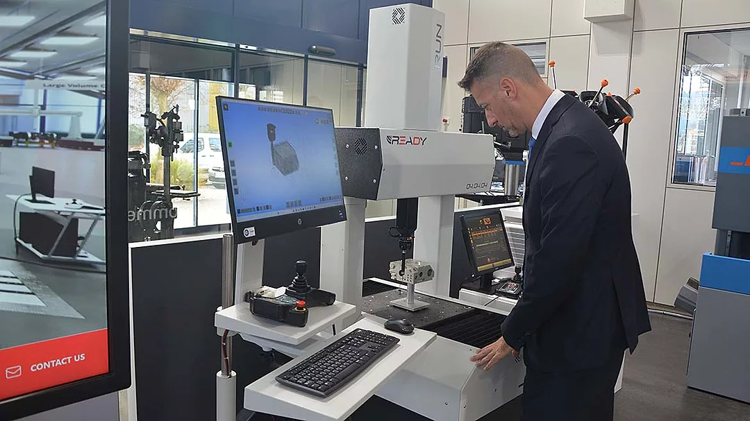

The image shows a Ready Shop-Floor Coordinate Measuring Machine (CMM) used for in-production quality control.

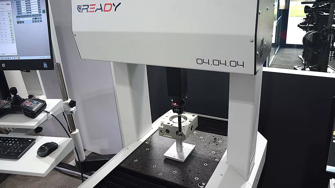

The image shows a coordinate measuring machine (CMM) designed for shop-floor use, identified by the brand name "READY" on the machine housing.
