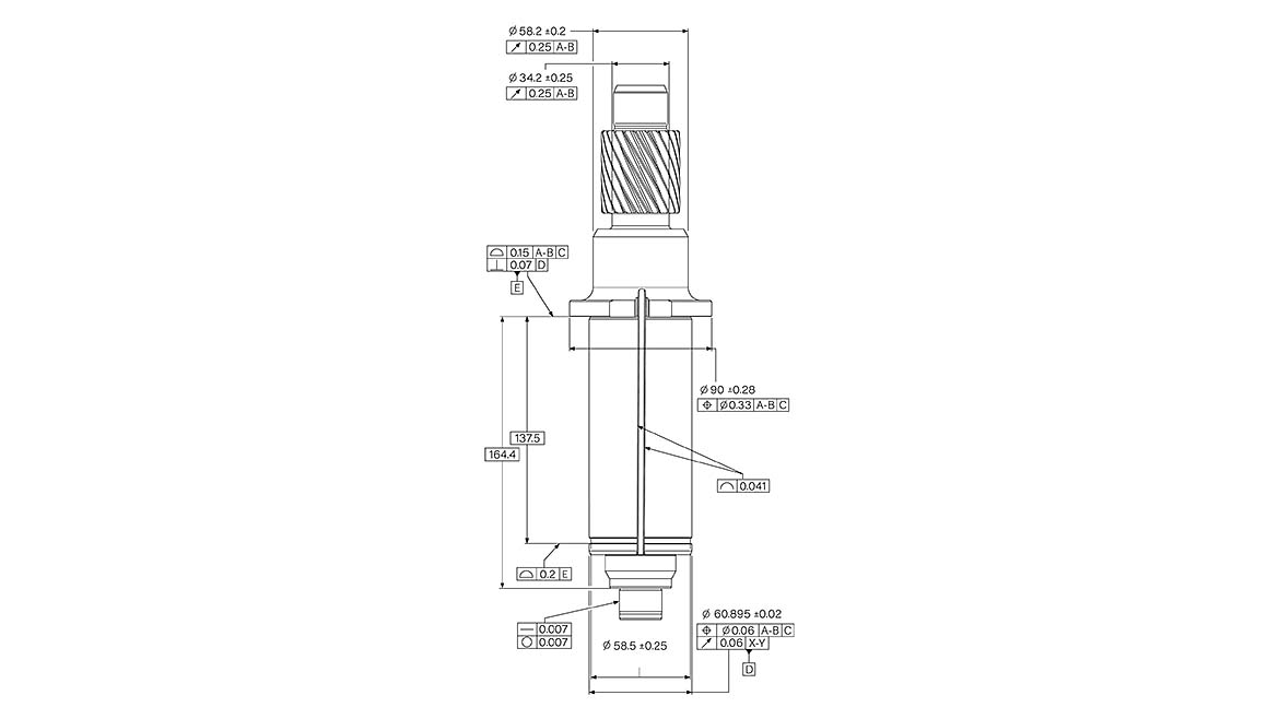

 a technical engineering drawing of a mechanical shaft
Image Credit: Adcole
Traditional size-only inspection methods are insufficient for these demands. NEV manufacturers require full-profile measurement capabilities that evaluate not just diameters, but complete form behavior across the entire part. This includes straightness, taper, angular location, axial relationships, and surface texture, all with repeatable, sub-micron accuracy. Without this level of insight, manufacturing issues often remain undetected until they surface in downstream testing or, worse, in the field.

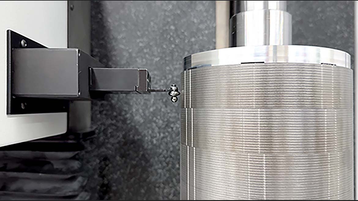

a CNC milling machine in operation
Angular measurement of lamination stacks

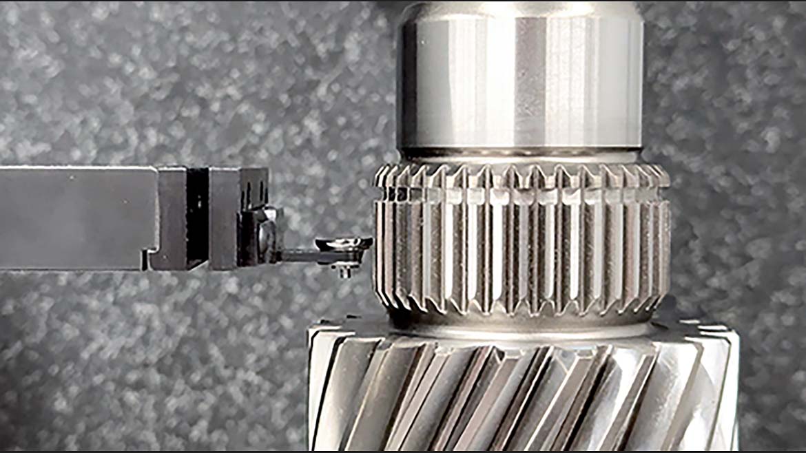

a precision gear measurement machine
Roundness measurement on rotor splines

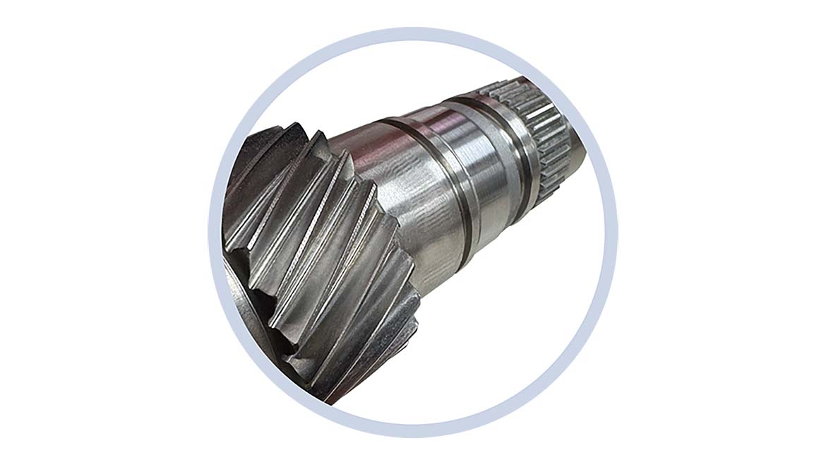

a helical gear shaft.
Shaft with chatter marks

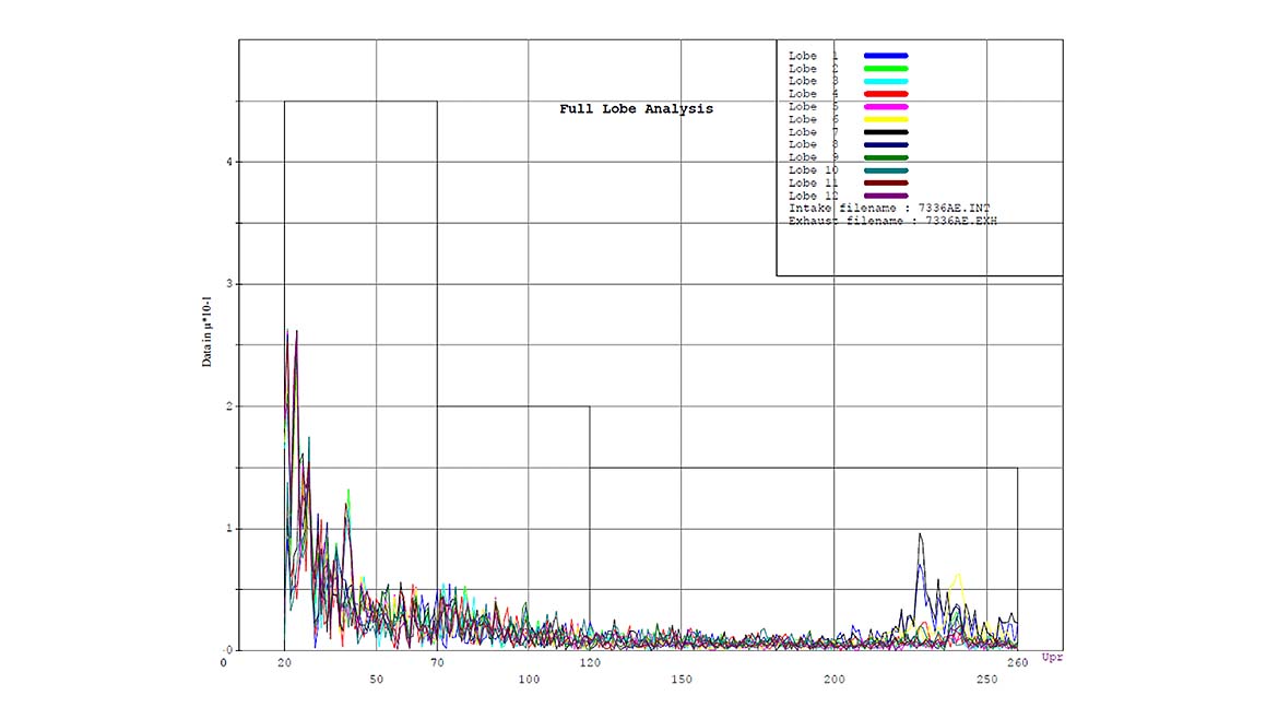

a graph labeled "Full Lobe Analysis" that represents spectral data
Lobe chatter data over the full 360 degrees of profile error data. The amplitude of the chatter gets muted (damped) when looking at the full 360 degrees compared to looking at just the base circle region.
By analyzing undulations per revolution (UPR) and isolating specific frequency bands, manufacturers can trace chatter back to its root cause such as a grinding wheel condition, dressing parameters, or process instability. This enables corrective action before parts move further down the production line.
