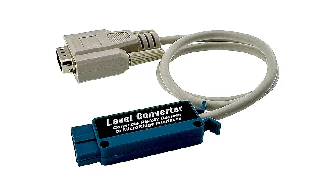

This is a MicroRidge GW-LC Level Converter Cable

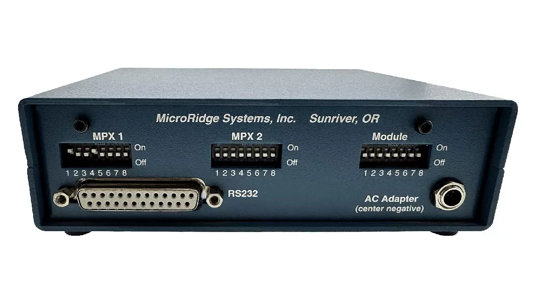

This is a MicroRidge Systems GageMux RS232 gage interface for connecting multiple measurement tools to a computer.

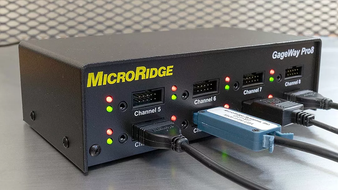

This device is a MicroRidge Systems GageWay Pro8 interface.

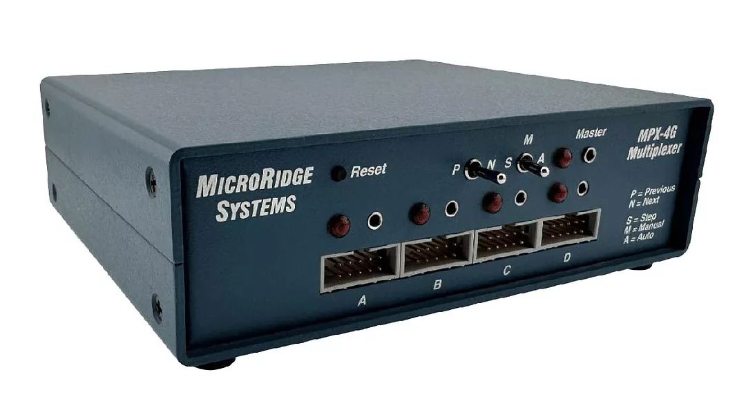

This device is a MicroRidge GageWay Pro8 interface box.

Supporting RS-232 Serial Devices
Only the industry’s best gage multiplexers extend beyond digital gage inputs by supporting RS-232 serial devices on each channel, so every port can be used for the instrument you actually need at the station. This is often done with an external level converter cable that takes RS-232 voltage levels down to the levels acceptable by the multiplexer. That means you can mix and match digital gages with equipment like scales, DROs, torque tools, and other precision measurement devices—then route everything through one centralized interface to your computer or PLC. The result is a cleaner, more flexible inspection setup that accommodates legacy serial outputs and modern gaging side by side.

Flexibility and Scalability
Gage multiplexers are built for flexibility, with common configurations such as 2-, 4-, and 8-channel models that let you match the interface to the size of your inspection station without paying for unused ports. As your needs grow, the best multiplexers also support chaining, allowing multiple units to be linked together so you can scale the system to accommodate more precision gages while keeping a consistent workflow to the computer or PLC. This ability to expand in stages—without redesigning the entire data-collection setup—is a hallmark feature of top-tier multiplexer systems.

Select a gage multiplexer that offers straightforward configuration and user-friendly operation. This will minimize the time and effort required for setup and reduce the likelihood of errors during data collection. When possible, avoid multiplexers that rely solely on DIP switches or cryptic terminal commands for configuration, since these approaches can slow down changeovers and make settings harder to verify or document. User-friendly interfaces and intuitive software support are essential for ensuring that your team can efficiently operate the system, maximizing productivity and minimizing disruptions. Investing in a system that is easy to configure and use can lead to significant time and cost savings in the long run.
